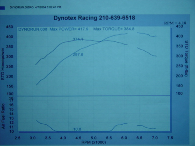

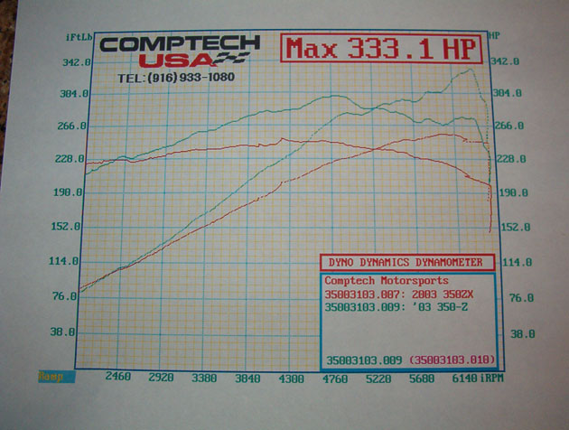

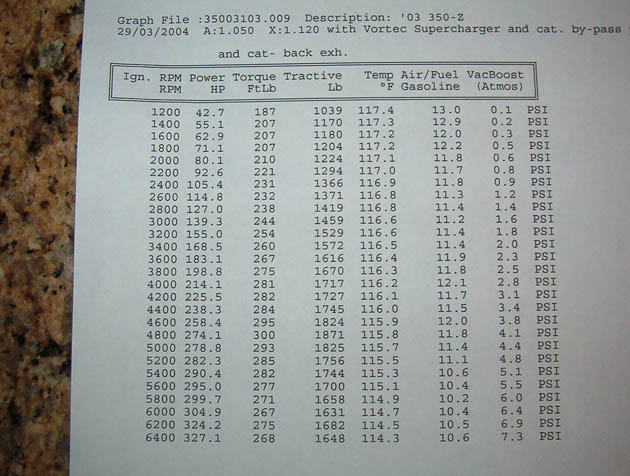

of course the power should be pretty instant then. What is being ignored over and over again is that second that the turbo hesistates(which is lag).
How's this, in 5th gear at 3000rpm a SC Z and TT Z both go WOT the TT will be at full boost by 3500-3750ish where will your SC be?? My guess is at the rear quarter of the TT....LOL. case in point Greddy TT at 8PSI:
https://my350z.com/forum/attachment....&postid=772477
And compare to this:
https://my350z.com/forum/attachment....&postid=752370
Graph here:
https://my350z.com/forum/attachment....&postid=752366
(thanks to those who posted this stuff earlier in the year)
Looks like your SC dont hit peak till redline, whooohoo so unless your at 5800rpm all day the TT will have boost in a much more usable band (gee sounds like a broken record)
Originally posted by little_rod
I don't think it is a bad thing, just part of a turbo. But seems like some of you guys are in denial of this lag issue
ok, if there is lag (and you say it isnt much) what about the SC? It wont reach full boost till redline, I think you are missing the fact that "lag" is in fact the instant gratification of peak HP and TQ at a low RPM all the way to redline. The SC is a gradual rise in power so there appears to be no lag because of its gradual increase. The truth is it takes longer to reach max boost in a Vortech SC then a Greddy TT
You can use all the terms you want, but the fact of the matter is in everyday driving, you will have that hesistation(lag). Yes, it maybe small, but it is still there
I'll say it again...The truth is it takes longer to reach max boost in a Vortech SC then a Greddy TT
