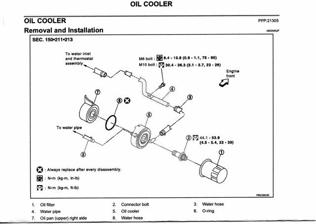

2003z's Avatar
2003z
Posts: 4,959
From: Atlanta
The oil is cooled by radiator fluid. There is a water line that runs through an adapter between the block and filter.
I have the oil pan spacer from JWT, it doesn't appreciably lower the clearance. the underbelly tray still fits on the car.
