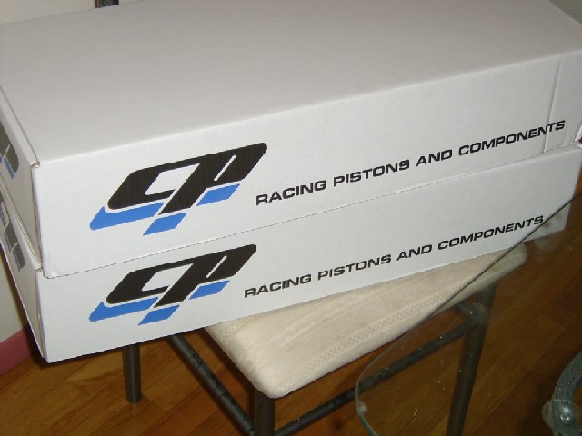

Thanks to Mr Darius Therman from CP Pistons we will be on our way to having the two fastest streed driven daily drivers on the east coast..Along with APS and ATI Procharger, we at MRC Motorsports will have some bad *** Z come next spring..Look out for us guys..

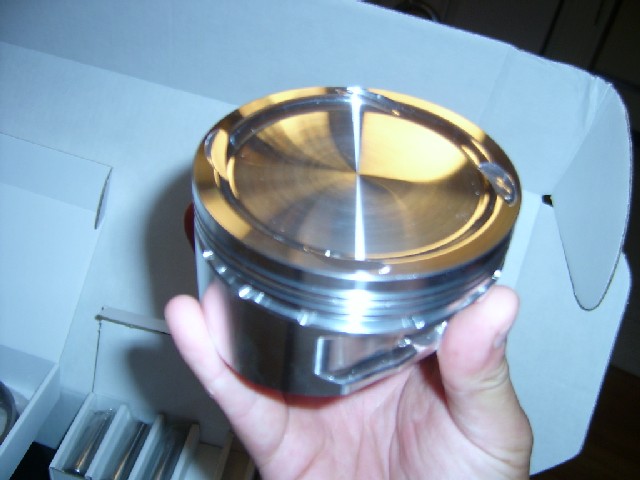

Mwuhahahaha
