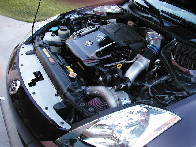

I started my Vortech install Wednesday night at 10pm. So far the install has gone ok, donated some blood and spewed a few f-bombs...
I think Vortech's instructions could be better and have better pictures. The tips that I got from Timrod 1011 were VERY helpful... thanks Tim.
No part of the install is easy, everything is so tight . Everything must be aligned perfectly, I spent an hour and half the intake downtube.
Hopefully I will have the intercooler and Fuel lines done tonight and be able to drive it Saturday night.
I went with the Zeitronix A/F with boost and EGT sensors, and Im going to mount the display in the Nav cubby.
Thanks to everyone on this board that has taken the time to post pictures of their install, they helped a lot.

what pulley is that on the front of the jackshaft?

Not sure, when I get home tonight Ill let you know.

Scott you have jackshaft pulley sindrom . Well that is the first thing I noticed to.....a bright shiny serp pulley.....I better go to the doctor

Yeah that doesnt look anything like the pulley that came with my kit? i wonder if its still the 333 pulley?

anyway , i digress..... whats the dim's on that spec pulley??

I am finished.. Everything went well.. sans a minor oil leak from not having the fitting tight enough. I still need to mount my gauge display and I am waiting for my resonated tests pipes to arrive so I can mount my A/F sensor.
Plan on tuning it in a week or so.
