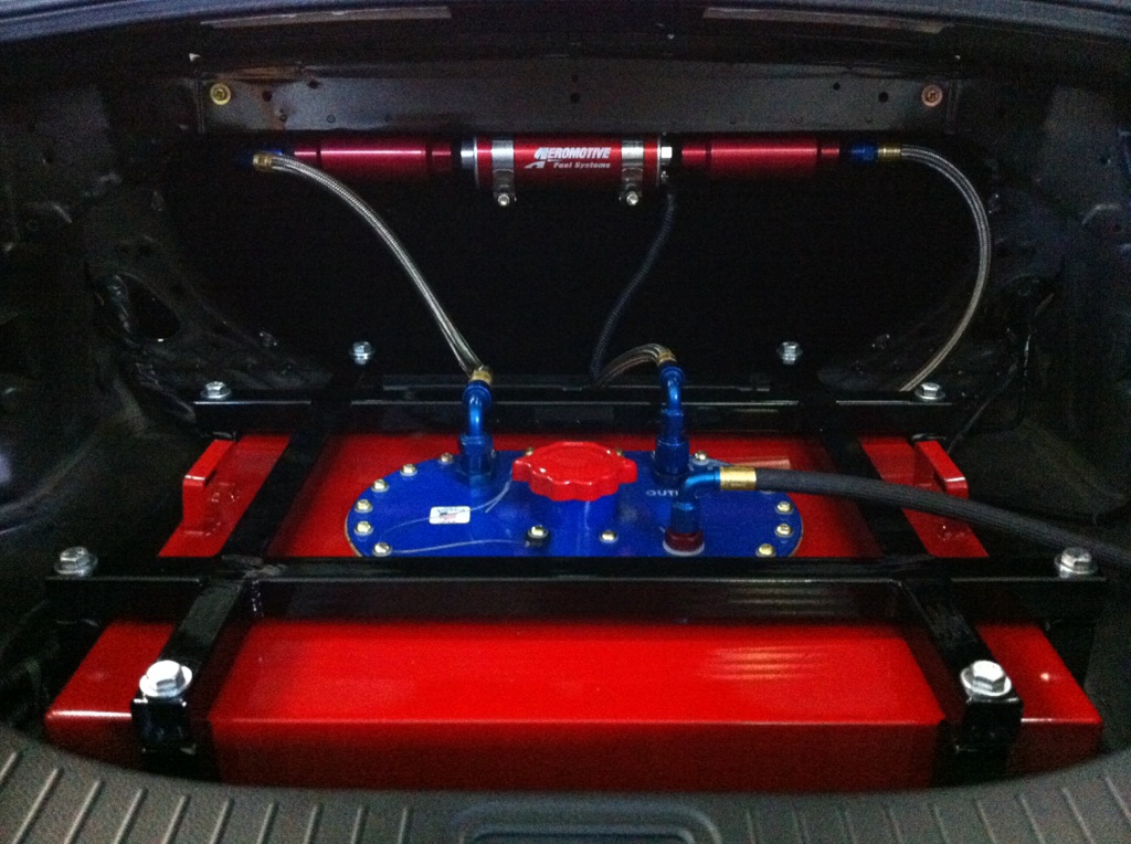

· ATI Fuel Cell

They aren't on the car yet as we are waiting for new hats and brackets to be made. Hopefully the next two weeks, ill take a pic tomorrow of the calipers... here is a video of the wilwoods failing on me haha - http://www.youtube.com/watch?v=OGmdj...ayer_embedded#!
