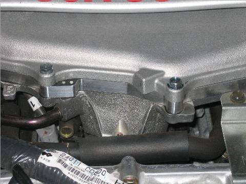

Old Mar 26, 2005 | 04:11 PM
Road Warrior's Avatar
Road Warrior
Posts: 2,669
From: cali
pic of plenum

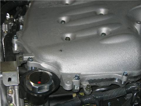

Old Mar 26, 2005 | 04:16 PM
Road Warrior
Posts: 2,669
From: cali
pic of spacer

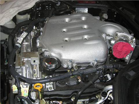

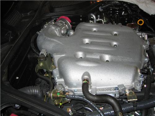

Old Mar 26, 2005 | 04:24 PM
Road Warrior
Posts: 2,669
From: cali
more pics
Attached Thumbnails aam plenum spacer review-aam-spacer-3.jpg   aam plenum spacer review-aam-spacer-4.jpg   aam plenum spacer review-aam-spacer-5.jpg

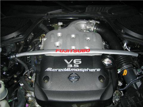

Old Mar 26, 2005 | 04:31 PM
Road Warrior
Posts: 2,669
From: cali
i recommend removing the intake tube that goes from the tb to the airbox so that you can move the plenum easier (freely by itself)....this allows you to line up your spacer and gaskets.
if you don't, you will have a binding feeling with the tube attached and its much harder to move the plenum (because the tube is attached and gives you mininum movement of the plenum).
the more i drive the car the better i like this mod....really gives a nice boost of power
also, on the strut bar i used two washers on all bolts except for the drivers side...i went two and a half...three would have been too high

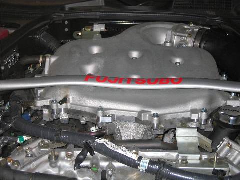

Old Mar 27, 2005 | 04:45 PM
Road Warrior
Posts: 2,669
From: cali
last pic completed install
note: if you have to use more than two washers you may need longer bolts...imo. i went a little longer on the driver's side since i had to go 2 and a half washers for that side and everythings fine.
seems like each time i take the car out it gets a little stronger...placebo maybe...but this mod has good bang for the buck
