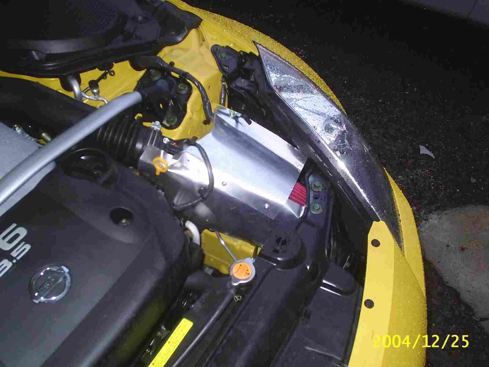

i just did my home made cai whit chinese filter cost me 20$ whit aluminium heat shield
i can difinitly say theres a difference pull harder down low to midrange maybe high end but not sure, sound is amazing i can get picture if wanted
i highly recommend doing this yourself cheap and efficient

Put up a picture, I have not seen any home made CAI, i might try it out if looks doable....I already have the heat shield from the JWT

Originally Posted by mikz350
Looks awesome! Love the yellow Z...how are your performance gains with this DIY CAI?

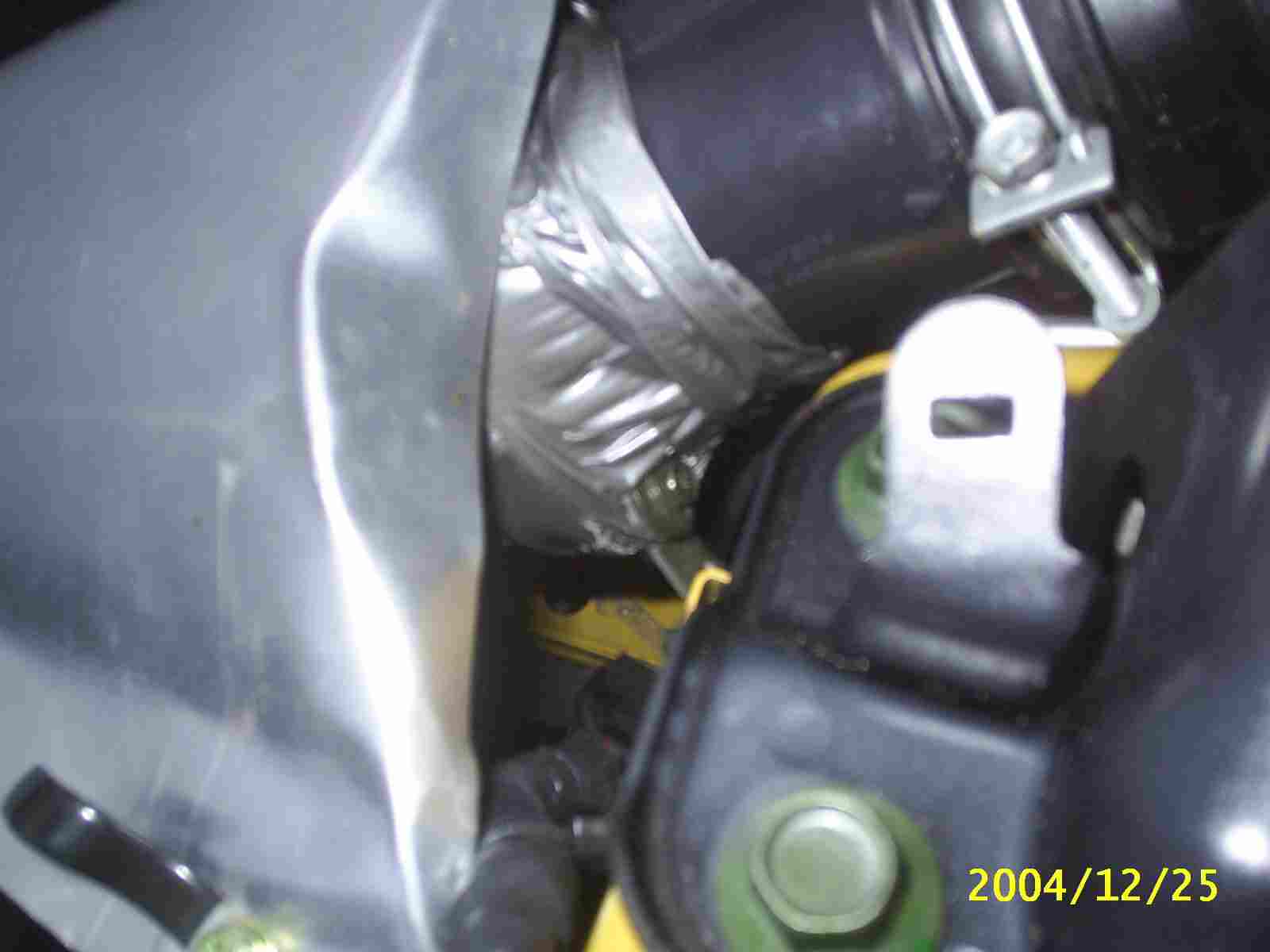

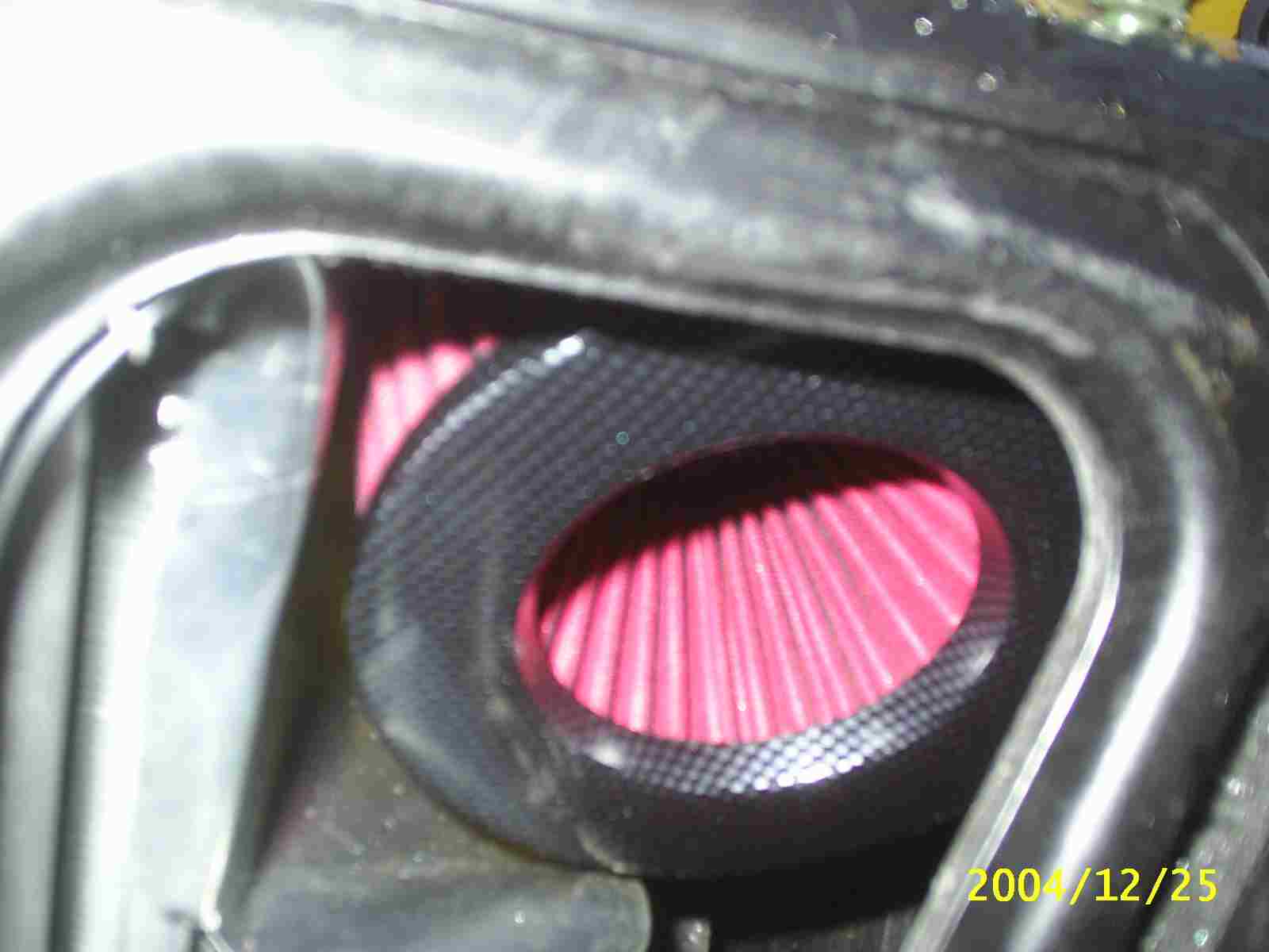

gata love duct tape!!. BTW, I dont think its a good idea to cover the top of the filter with the heat shield. Might be limiting it

i like the heat shield on top cuz it will likely eliminate heat comming from hood in hot summer time
as for duck tape who care ?

the hard thing to do is to collet the filter to mass air flow for this you will need to take off the ventuly ring in the oem air box that collect to maf by drilling the clip so it will take off easely then take your chinese filter and fit it in ventuly ring then scew it to maf
