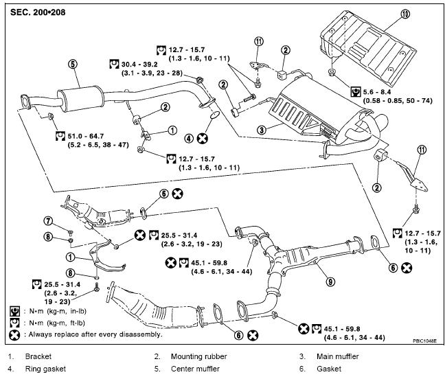

On the picture above:
9 = Y pipe with flex joints
5 = B pipe with resonator
3 = Back box, aka Rear muffler (the number (3) points to the muffler diffuser attached to the actual muffler).
6 is the gasket that connects the Y pipe to the cats so although they are not numbered the two cats are shown.
