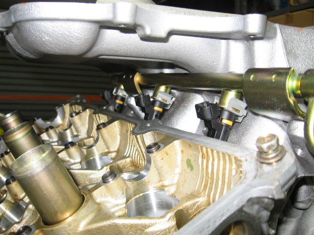

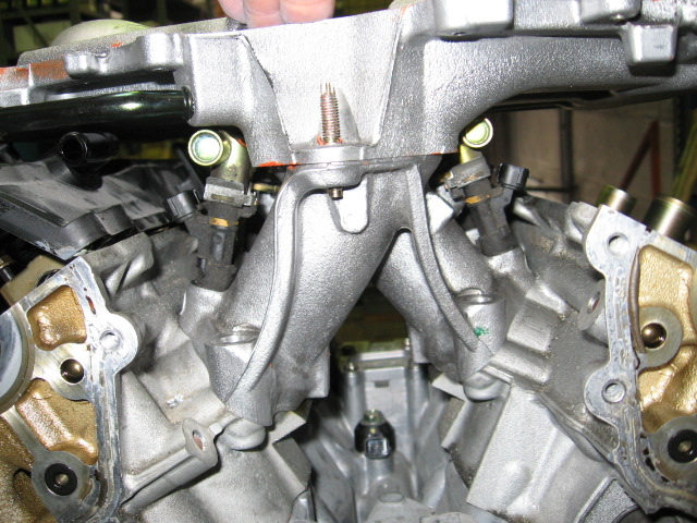

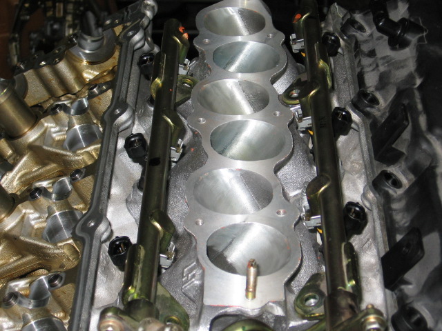

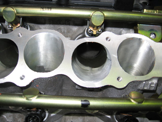

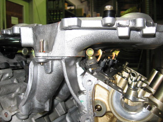

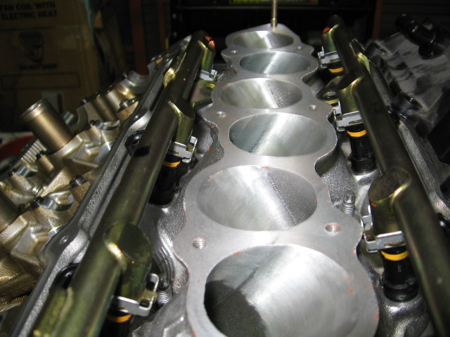

some more pics of progress.
top left notice bolt holes& freeze plugs welded shut
top right and both middle notice distance between fuel rail and bottom of
lower intake plenum
bottom left ported lower intake

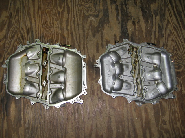

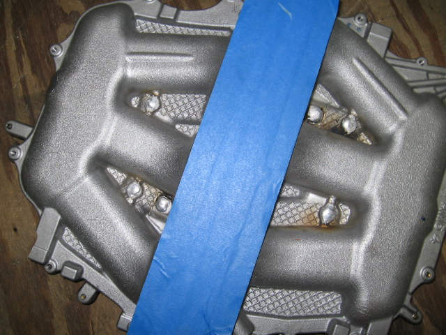

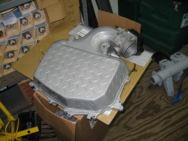

more pics thanks for checkin it out mike
top left new powder coat
mid rev up non, revup
top right ports from front
btm left ports from top
Attached Thumbnails New Custom Plenum!!!!-vq-35-008.jpg   New Custom Plenum!!!!-vq-35-009.jpg   New Custom Plenum!!!!-vq-35-012.jpg   New Custom Plenum!!!!-vq-35-013.jpg
