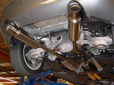

HyperSprite's Avatar
HyperSprite
Mad Scientist
Posts: 2,795
From: San Jose, CA
I think from the description the OP has the first version like the ones pictured here. The biggest difference besides the amount of sections is that the earlier system has removable silencers where as the one posted directly above has them welded into the back boxes.
As far as rubbing, first try loosening up all the connections and moving the back box around to see if you can get it where you want it, in the end you may need to bend the hanger so get it to sit where you want.

Thank you, this is the exact exhaust I have. I guess it's time to bend the hanger.
