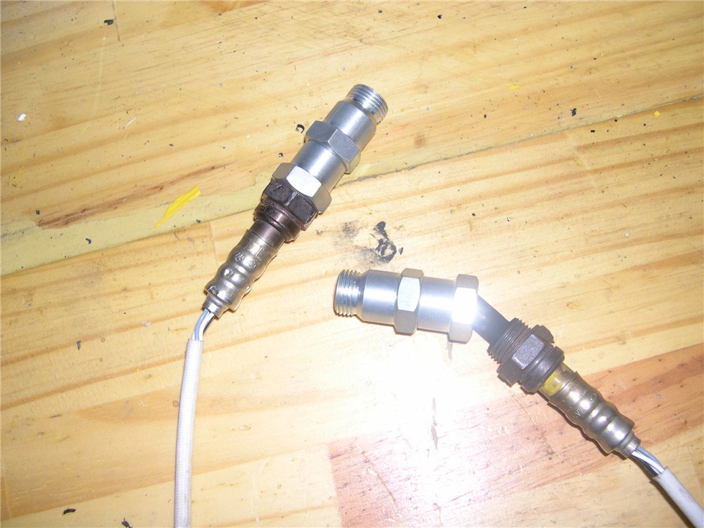

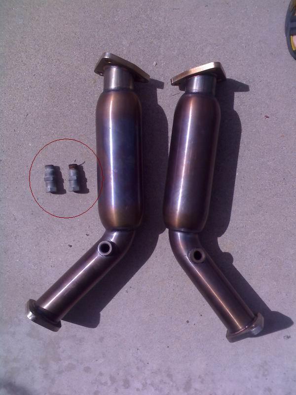

Some pics would be niiice to help ya out... Did they stack two nonfoulers together like this?

On a 2003-2006 you will need to drill the non foulers out with a 1/2" drill bit. The 2007 model will require a larger drill bit. Take a micrometer and measure the O.D. of the O2 sensor probe. Then use a drill bit just slightly larger and you should be fine. If the drill bit is to big to fit in the non fouler without obstructing the threads then that means you will need to get a set of Nissan O2 sensors for your car. That is only if you come to the conclusion that the Bosch probe is larger then the Nissan probe...
