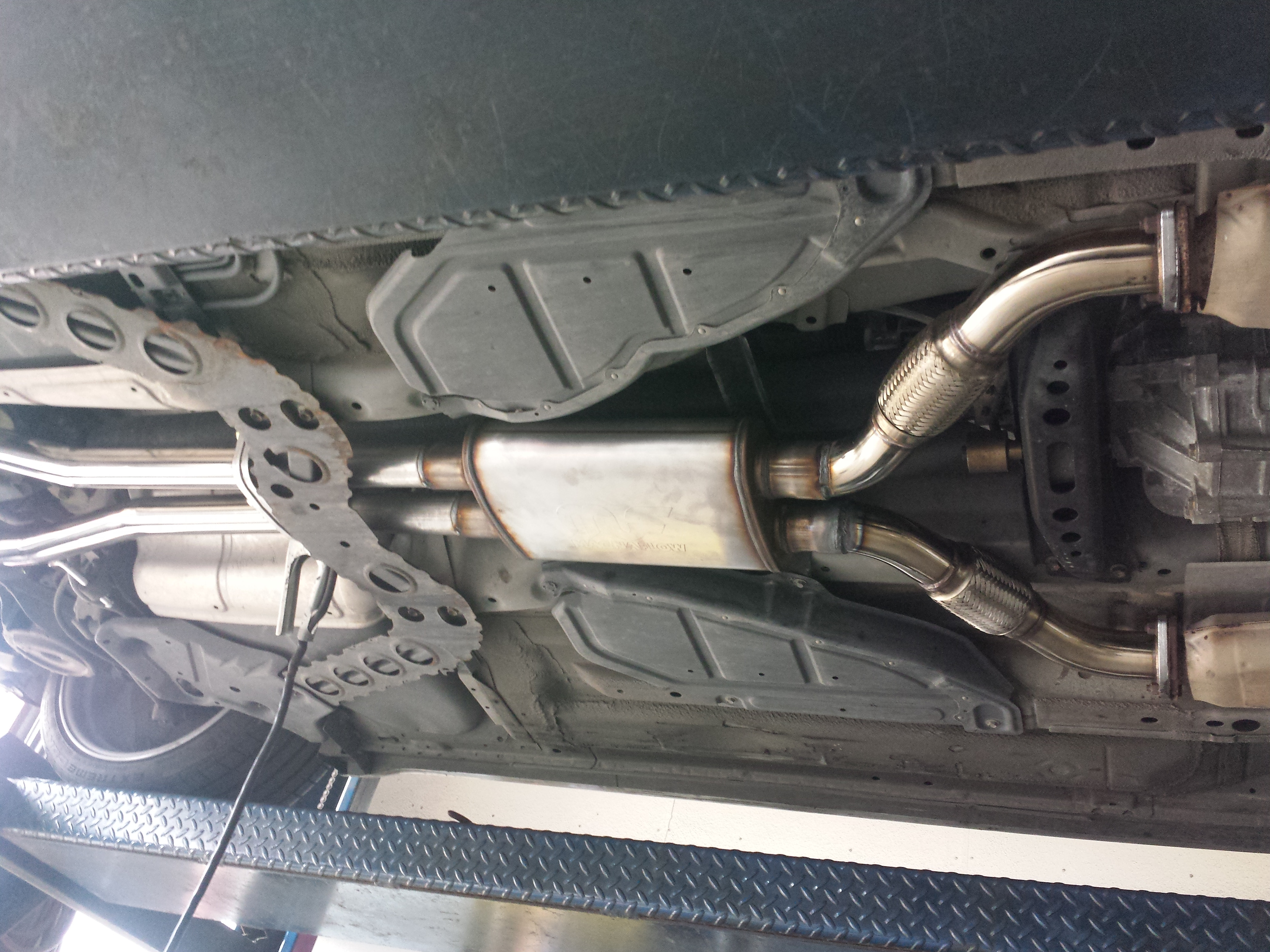

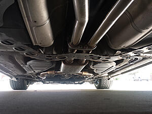

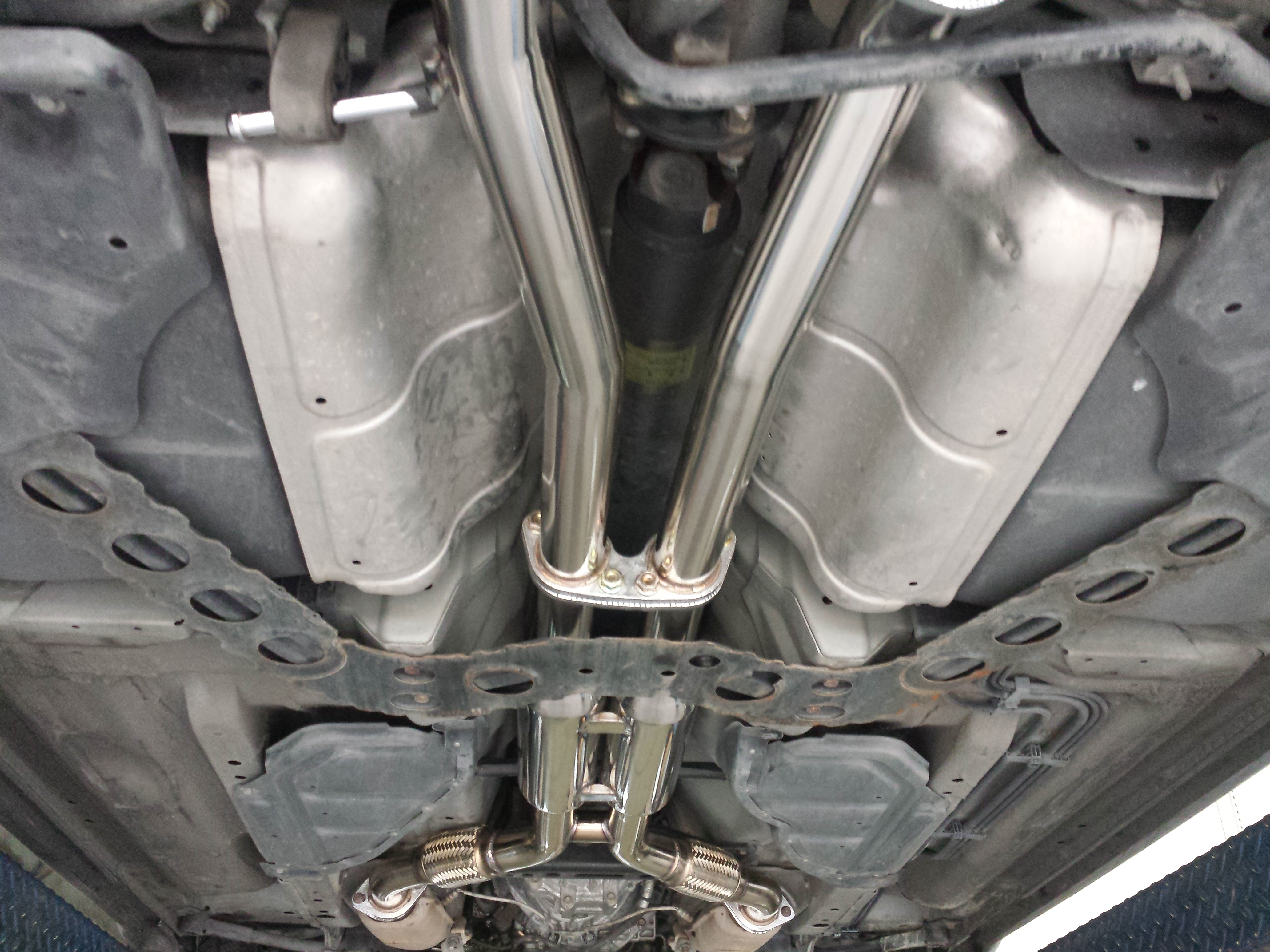

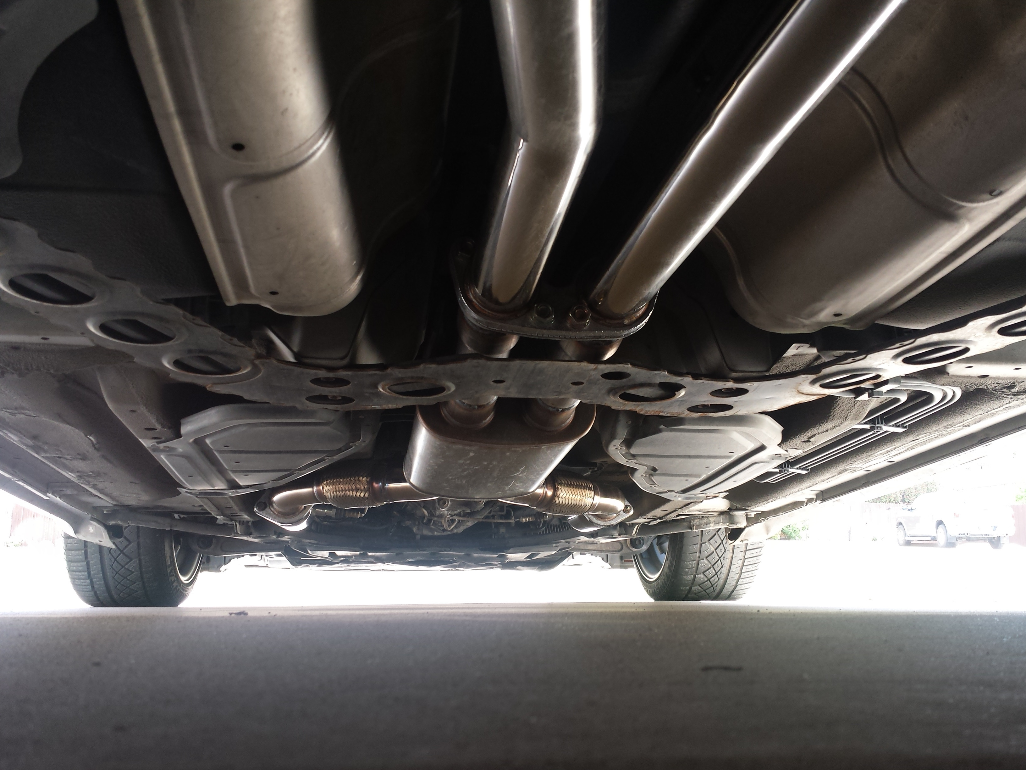

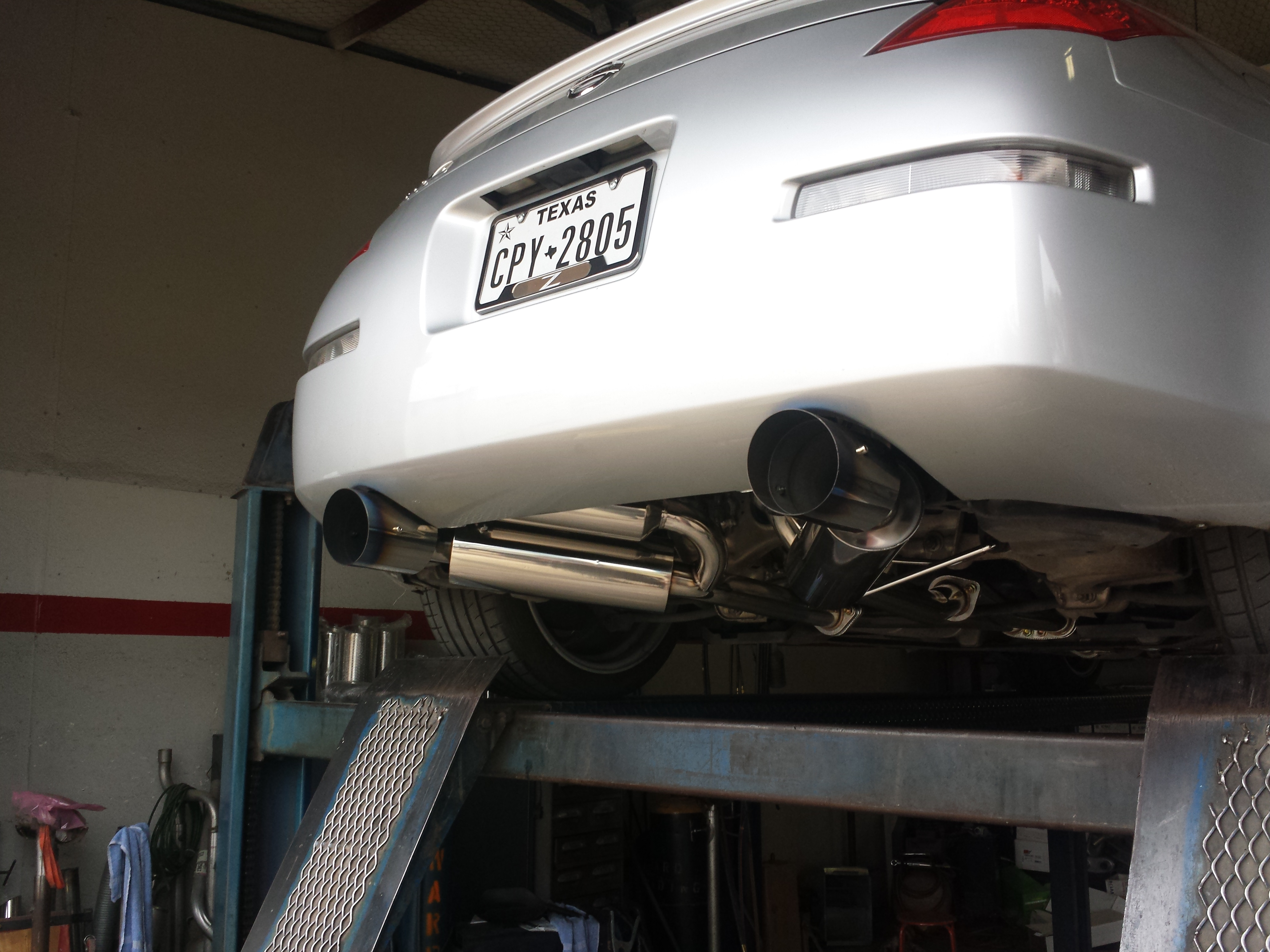

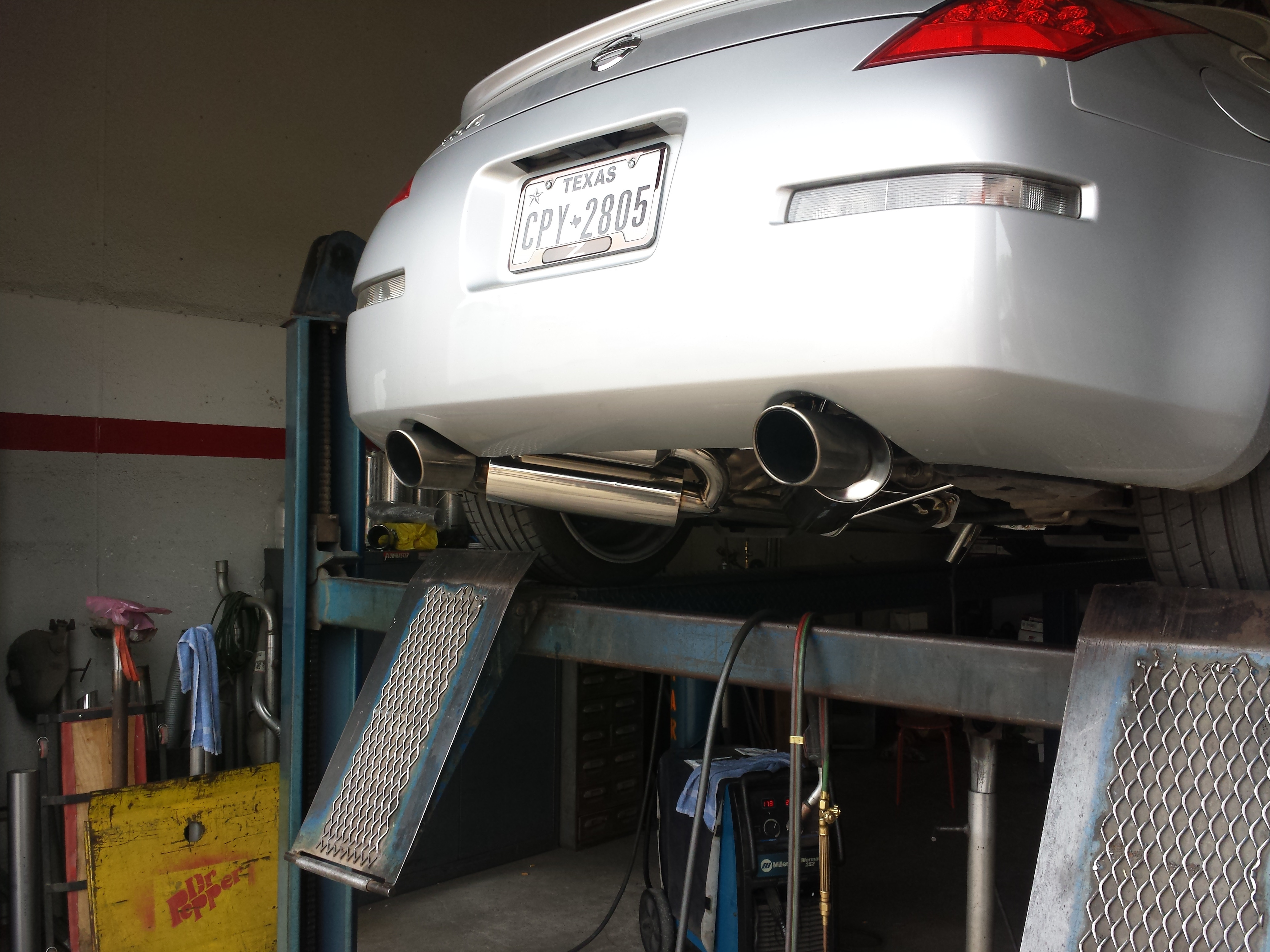

Here's what I did -
-HKS replica exhaust
-Top Speed resonated test pipes
-Magnaflow #11386 resonated x pipe/muffler
-Stock tips welded back on in place of those ugly burnt ones.
Before:
Replica HKS Exhausts Ebay/Godspeed-idihqnr.jpg
Magnaflow welded in
Replica HKS Exhausts Ebay/Godspeed-lgmoto3.jpg
Tips before:
Replica HKS Exhausts Ebay/Godspeed-lslglhs.jpg
Tips after:
Replica HKS Exhausts Ebay/Godspeed-e6z6zxg.jpg
Rear shot:
Replica HKS Exhausts Ebay/Godspeed-8xis475.jpg
Replica HKS Exhausts Ebay/Godspeed-xiegmh9.jpg
Video:
Having some issues with the driver side pipe vibrating against the rear sway bar when downshifting, and the revs are at 2800-3300 rpm.
