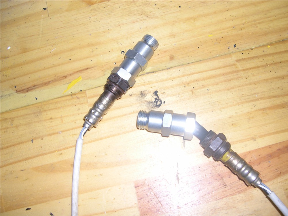

You need Spark Plug Non-faulers. Two for each side. Then drill two of them with a 1/2 drill bit. Place your O2 senso in it and then screw it to the tesp pipe. Reset engine light and you are done. Do a search for a DYI, I know is on the site somewhere.

pic
Attached Thumbnails Eliminating Check engine light???-non-fouler-20022-1-.jpg

Default I bought mine from Zexy for $20.
Originally Posted by DaZfan619
Where can i Buy these foulers you guys are talking about need them asap....pm me please
Drilled and ready to install. Never a SES light problem.
+1
I purchased mine from forum member "Zexy"..
