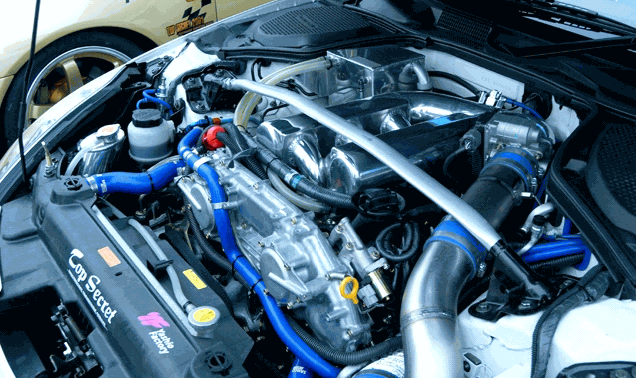

I'd like to see a complete redesign of the intake manafold. Something along the lines of the top secret setup. I cant find a picture, but maybe someone has a link to the gallery with the magazine scans...

Picture of Top Secret's. They use a single turbo which requires this setup.
Nissan350ZTT -
I don't think top secret uses a single turbo setup, I just think they used the redesigned manifold because with that setup they are getting only 5-10% less air into the front cylinders (like the crawford Z plenum but doesn't look as ugly). I may be wrong but as of the article in Turbo they are still using twins.

someone please design and fabricate one like Top Fuel, that looks awasome!!

Originally posted by 350zdanny
Nissan350ZTT -
Dan
It is a single turbo setup according to a guy on here who has visited the Top Secret site in Japan and has seen the car. He spoke to one of the engineer's there and they said they couldn't figure out how to use two big-sized turbo's like they wanted with the space available, so they switched to a single.

Wow I can't believe they changed their whole setup just like that. Do you have any idea if the intake plenum is going to be available here?
The intake plenum is going to be in the kit, I don't know exactly why you need it with a single and not with a twin when they're making about the same hp.

The Top Secret Turbo Kit is a single turbo. It does include the plenum. The problem is the put it on the passenger side which in the USA is the drivers side of the car. THe Top Secret manifold will not work due to the rack and pinion. So if you were to buy the kit you would have to have a new header made and the single big turbo would probably not fit in the USA drivers side of the engine bay.
