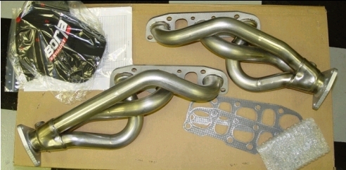

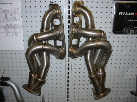

Today I was looking at the Borla headers and they seem to have bung holes in them already. They're hard to see in the pics, but look back end. At least thats what I think they are. The NISMO headers have them as well. Wouldn't the O2 sensors plug in there?
If this is so, couldn't we just run straight pipes or hi-flow cats from the headers and not worry about the sensors going off?
P.S. I "stole" these pics from other posts. Sorry I didn't ask first, they're not modded in any way.

NISMO headers

true, there are bungs for O2 sensors in the headers. The system uses 2 sensors per side, one before the CAT and one after the CAT.
Don't worry, yours will have both.
