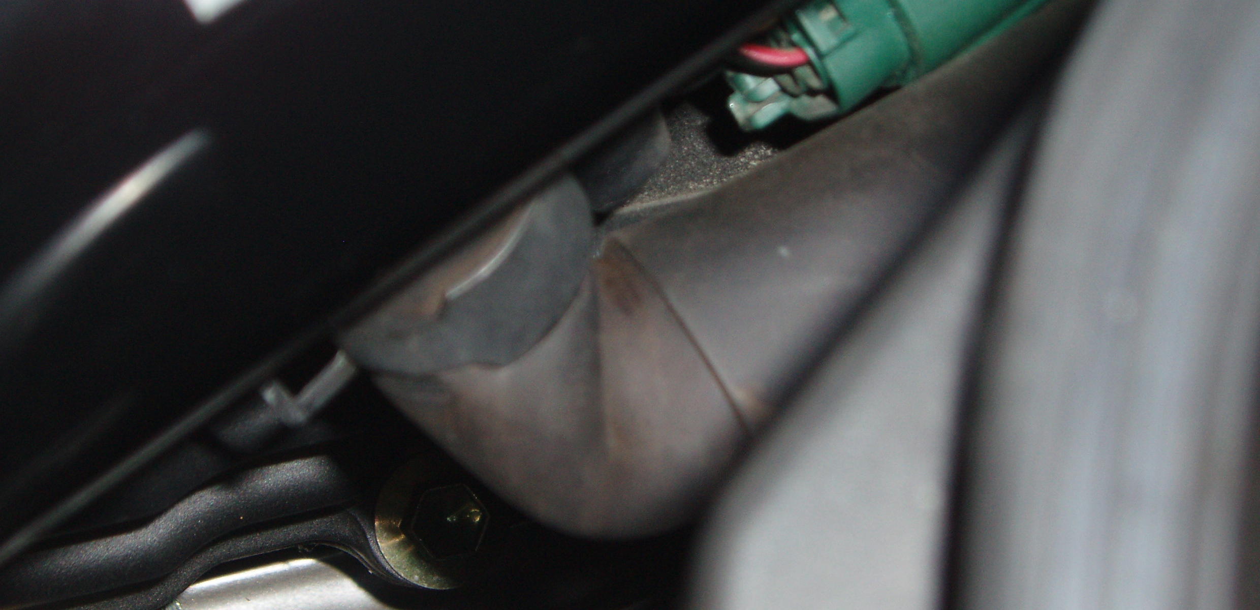

Much Thanks to Hraesvelg as he's right on the money, I've snapped a picture of the problem, anyone know how to fix it without having to take the whole thing apart? Its very hard getting my hand down there to try and do anything
I don't recall if I had to take it apart or what, I had that problem about 5 years ago.

You'll probably have to take it apart but find the diameter of that hose, go to home depot or hardware store of your choice. But a 90* fitting that will fit the hose, cut said hose...voila, done and no more high pitched noise.
