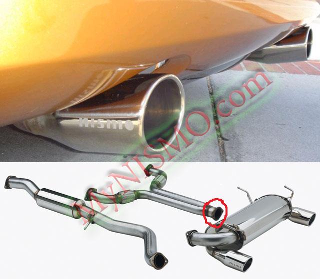

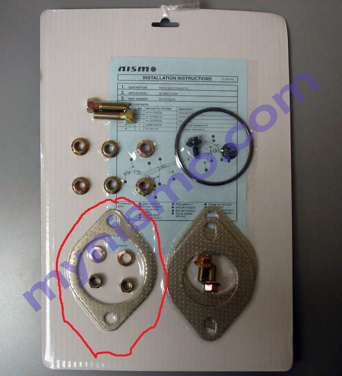

1. Does anybody know if the circled gasket in the Nismo packaging pic, is the one that goes between the mid pipe to the resonator piping? Is this Nismo gasket made out of aluminium or some kind of metal or made of some kind of composite material that will just break down and blow out in 6 months?

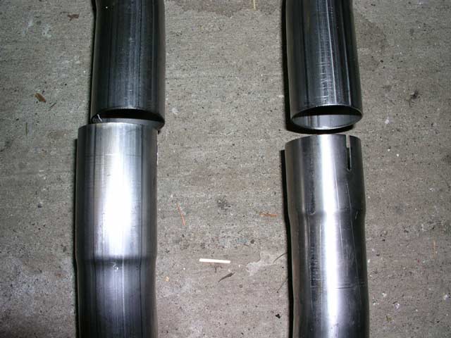

2. Has anybody had some kind of slip pipe conector custom welded to their exhaust like in the pic below by just ditching the whole flange/nut & bolt gasket connector stuff? By using the slip joint connectors and a U clamp or two it might be easier for somebody to remove that section to replace the clutch and there would be no gaskets. But I'm thinking even with the slip joint they would still have to remove the exhaust canister section anyway to be able to slide them apart.

Will the OEM multi-plate metal gasket used in the same area not work? Those gaskets pictured are absolute junk and any shop will have those available for a couple of dollars. The OEM metal style gaskets work far better and will never blow out. The OEM gasket might not have the exact bolt spacing, but you could always drill those out to make them work. What's the inner diameter of the Nismo setup? OEM is around 2.45".

those gaskets pictured are nismo gaskets.
so i believe they would still be considered OEM quality

They might be Nismo, but they're not near as nice as the metal multi-plate gaskets that come on the OEM exhaust. The Nismo gaskets pictured are no different than the ones available for $2 at one of thousands of exhaust shops in this country.

It leaks from whatever part of the gasket gets the weakest and blows out. I've seen a couple of the previous blown gaskets and they just looked like they were fried from heat. Brittle, thinner in some spots than others and kinda charred crispy looking.

If you do decide to fab up a coupler, just make sure it's made of stainless...

That doesn't look like the Nismo gaskets we get at our shop from Nismo and we buy direct, not through a dealership. I'd double check that, maybe they've updated their gaskets in the last two years, but Nismo packages come with the stock style gaskets on all the stuff we've done.

Well I just had them install another gasket. The one they took out was one of those composite looking things and as I figured it was fried/crispy, like the previous ones. This time they put in a metal/multiplate gasket type.
I didn't plan on leaving without having it welded shut permentally this time but since I wasn't sure if all the previous gaskets were that composite stuff, I would give this metal one a shot.
