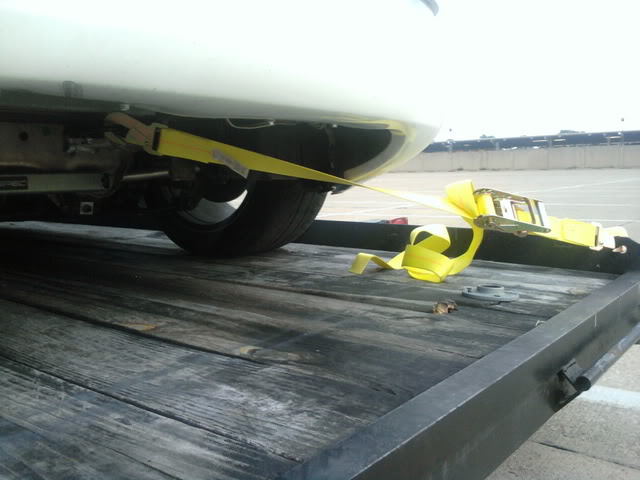

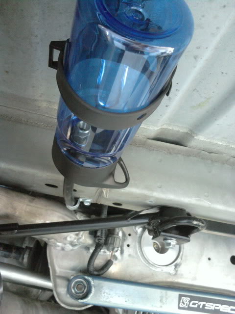

Form follows function:
I have a single exhaust because i track the car ONLY. track only z.
that being said...
1. (EASE OF REMOVAL - to work on track car)I have a custom single exhaust that i paid to have a local shop weld together. I designed it to where the bolts are welded to the corresponding flanges and it takes 3 easy to remove nuts to drop the ENTIRE exhaust.
so, having a track car that im constantly working on, i can drop the exhaust in a few minutes.
2. (LIGHT Weight - again, cause its a track car) due to single over most dual exhaust systems, my system is super light in comparison to others.
3. (Diff service - Track car) due to single, and not taking up tons of space in the rear, i can service the rear diff easily.
4. (Diff overflow) I now have room in the rear for diff overflow can - this allows me track side to monitor my diff fluid overflow and replace as needed. having the single gave up tons of room to mount this.
5. (pin stay towing tie downs) I now have no dual can crap in the way where i welded D links to my rear pin stay and now have a direct frame tie down when towing my car to events. makes loading and unloading the car onto the trailer super super easy..
etc..etc..etc....form follows function...
