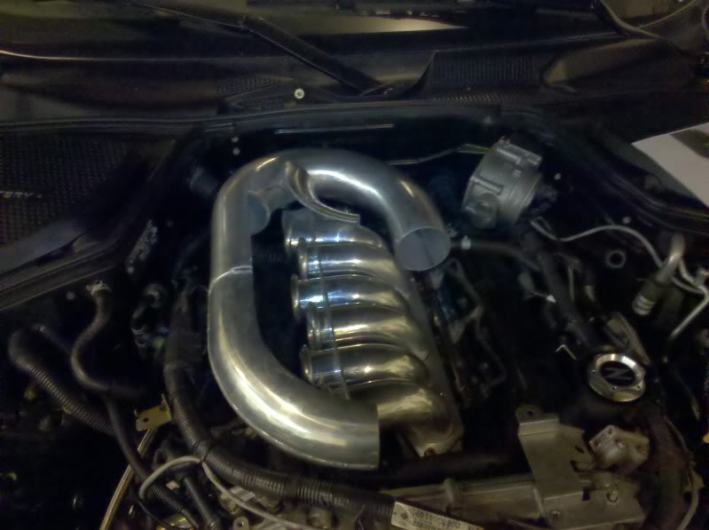

Old Oct 27, 2010 | 06:51 PM
ChrisNelson's Avatar
ChrisNelson
Joined: Jun 2008
Posts: 417
From: Bemidji, MN
This is a picture of the construction of the Kinetix SSV manifold:

Using a larger TB (with less dramatic elbow from TB to manifold) and intake tube should net you more power, but it doesn't seem like the design of the Kinetix is that much different. It has a vstack design as well. Is the diameter of the stacks larger?
The Kinetix design does not have true velocity stacks. It is more of a pipe flair... IMHO a poor design. I think their intake would work better without that flair, but it's tough to tell. The full radius on our design will be much better than Kinetix.
Kinetix:
Mine:
Also, the flow from the TB to the plenum will be much different than Kinetix design allowing air to flow more naturally... If all goes as planned it will be finished this weekend.
