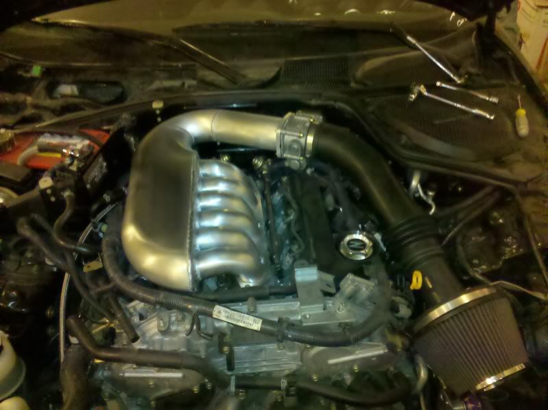

Slowly but surely this engineering project is wrapping up.

Likes: 25
From: westchester NY
looks good... cant wait till its proven

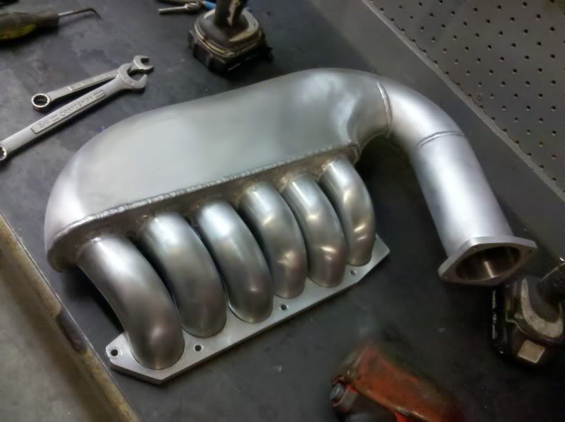

looks really nice! cant wait to see results.

looks like a nice piece, i like the clean up on it. let's see some good results!

Hmmm... looks like the rear cylinders would be starved for air. That neck bend is so asymmetrical and severe on the DE motors - hard to fix with any design but looks like a solid attempt. GL!

I'm not seeing the rear cylinders starving, but I have a little bit of a question about velocity. The collector area looks like it may cause a bottleneck depending on the interior wall and horns setup. But, aside from that looks like a great prototype.
The Fontana guys used what I think is the best design for outright peak figures.

awfully hard to tell if something is starved for air by looking at it
a flow bench and a manometer are absolutely necessary
