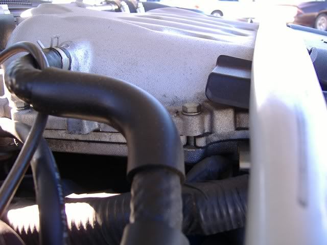

I'm curious how to tell if there has been a plenum spacer installed? The stock front strut bar is installed. Whomever owned it before me seems to have known what they were doing with modifying it and I have a sneaking suspicion that they may have done the plenum upgrade.

You can see the spacer if it is installed. it would be a 3/8 in. metal rim between the plenum and the block.

u would see the spacer between the upper and lower intake manifold..if there is nothing there then there is no spacer, also there would be spacers on the strut bar mounts to raise it

Here's a link to a gallery of the pics.
http://www.dropbox.com/gallery/9507555/1/350z?h=4b63f3

My bad. Spacer is clearly visible here.

PIC DSFC1857.JPG CLEARLY shows a plenum spacer...notice at the bolt you can see the notched spacer thats inbetween the plenum..
the bolts are basic zinc coated Metric bolts as well with a washer under the head.........nissan oem is green iirc...
