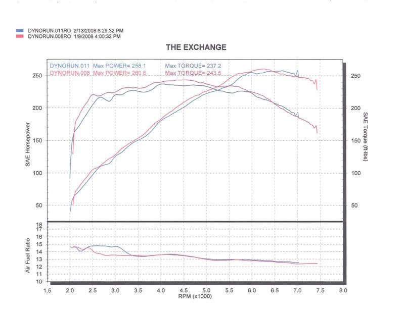

If you have the non revup engine, see these links.
Below is a comparison of Stock Vs Spacer Vs MREV2 Vs Spacer with MREV2. All of this testing was performed on a 2004 G35 with the non-revup engine.
http://i352.photobucket.com/albums/r...l31Plot1-1.gif
http://i352.photobucket.com/albums/r...ril31Plot2.gif
http://i352.photobucket.com/albums/r...ril31Plot3.gif
http://i352.photobucket.com/albums/r...ril31Plot4.gif
http://i352.photobucket.com/albums/r...l31Plot5-1.gif
Also see this link to an independent test on a NON-REVUP engine.
https://my350z.com/forum/intake-exha...5-touring.html
If you have the REVUP engine you definetly want both the MREV2 with the spacer.

ONAGAO spacer and mrev2 on a revup engine
https://my350z.com/forum/attachments...comparison.jpg

Its a lot of links, but its everything you could want to know about these modifications.

the spacer is all you need on a non revup DE
