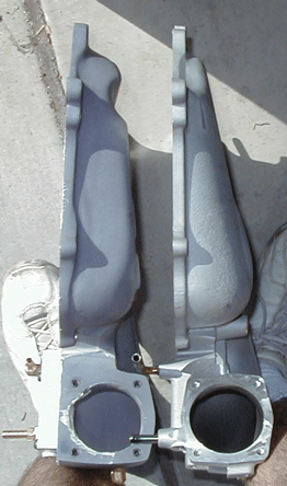

and I think someone asked for some of these...
Attached Thumbnails Kinetix Prototype Plenum Photos - HERE!!!!!-top-side.gif

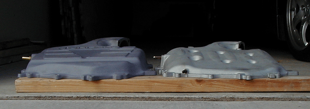

heres another...
Attached Thumbnails Kinetix Prototype Plenum Photos - HERE!!!!!-front-side.gif

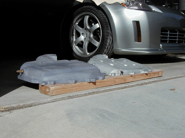

and this ones my favorite out of the three!
I wonder why?????
Attached Thumbnails Kinetix Prototype Plenum Photos - HERE!!!!!-side-by-side-with-z.gif

All_bark, thanks for those pics!

all_bark,
Sweet picture. Did you test fit the engine cover with the plenum? If so how did it fit?

all_bark, THANKS for the comparison pictures. They appear to show a substantial difference. Wishing you and LSD well with the dyno testing!

Also take notice in those pictures that the factory plenum material thickness is about .25". Our plastic plenum is also .25" except where it dips down for the strut bar, at that point is thins out to about .08-.1" so by minimizing clearance between the strut bar and plenum, as well as minimizing material, we are able to gain considerable volume under the strut bar.
I hope I have answered most all of the questions, as I have been on the forum about 5 times a day trying to keep up with all the questions.
I wonder why?????
Thanks...that's what I wanted to see.
I'll stick with my Crawford plenum without any airflow disturbances for the strut bar placement.
