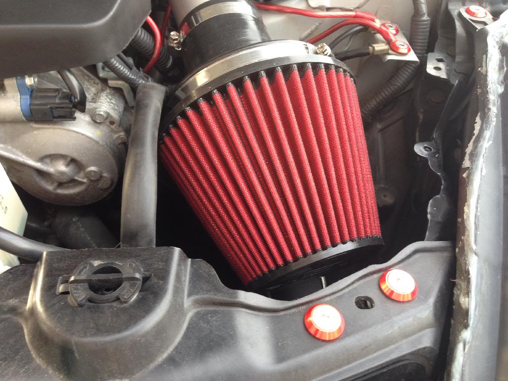

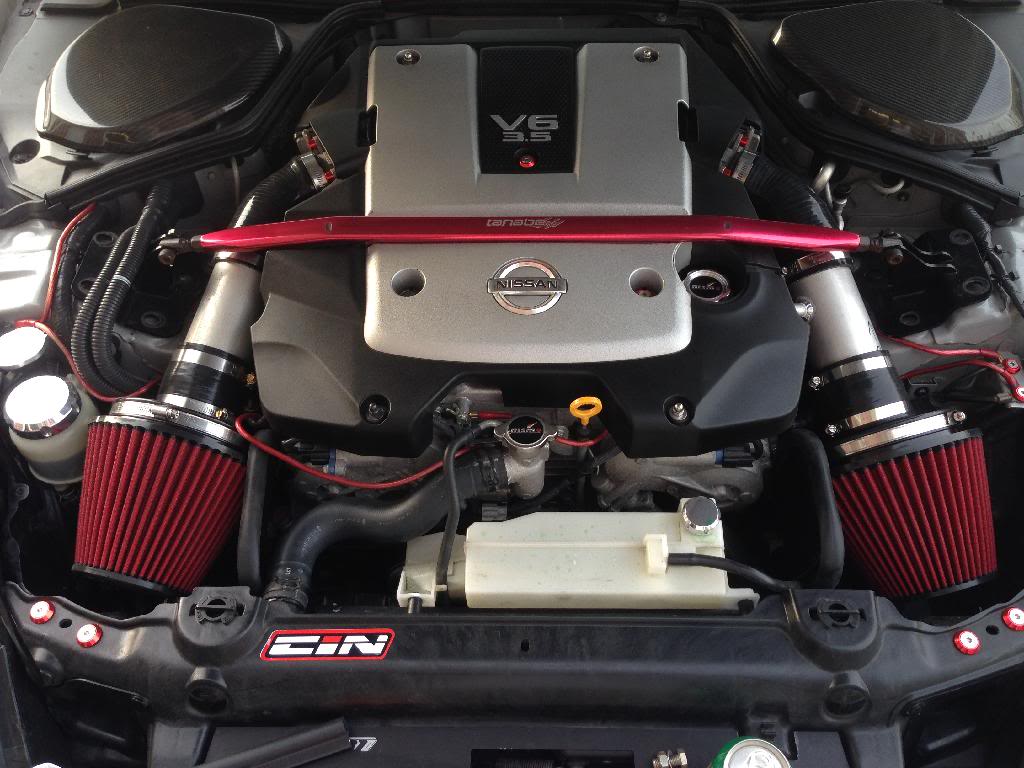

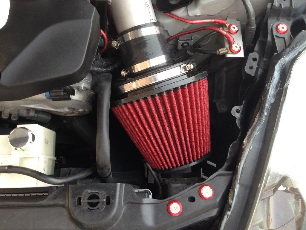

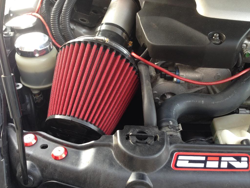

Bought some K&N heat shields. They're for the K&N intakes but I decided to wing it and see if they'd fit. And they did. I bought the heat shields and edge trim for both sides. Would have got the mounting hardware except they said that alone was $102. No thanks. So for the shields and edge trim it was like $101 shipped. I used black zip ties mainly to mount them haha. Not like anyone can see it, and they're definitely not going anywhere with these big *** filters. Anyways. I know it's not as good as an enclosed box but it's definitely better than nothing and I'm sure it will help.
Here are some pics:

You gona get them air tubes anodized to match that pretty strut bar and bolts?

Looks good! Those should get the job done; sealing off the gap over the top also with that padded material is key with them working well. Good work!

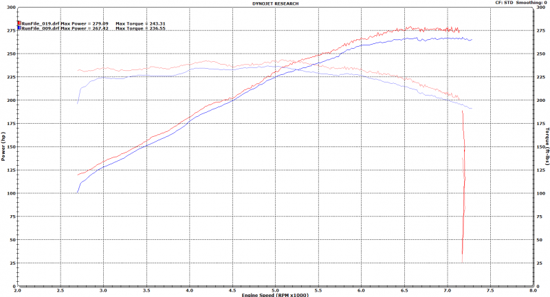

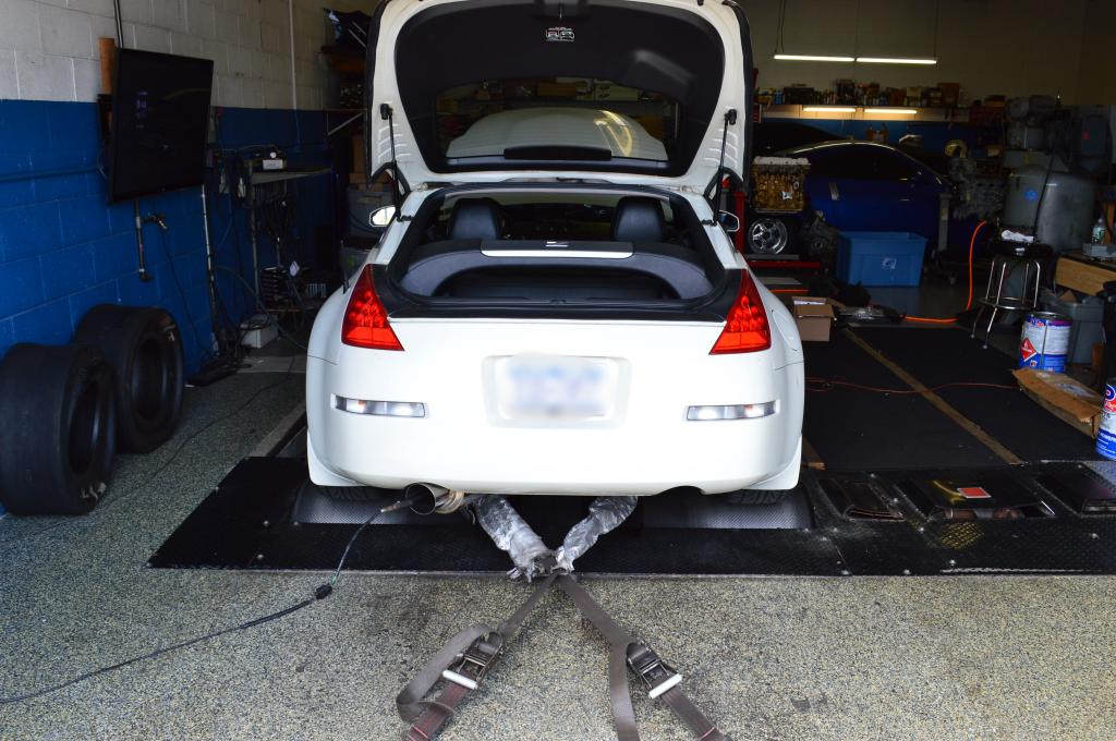

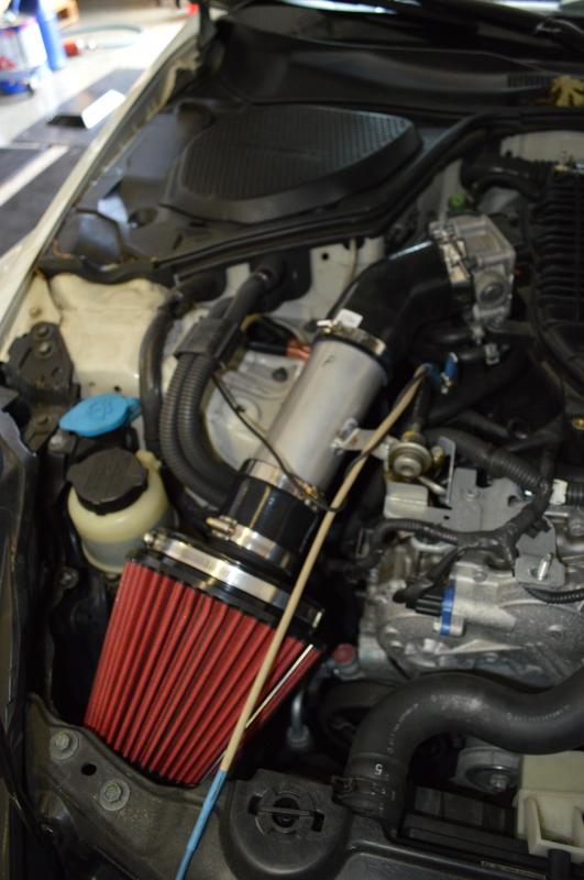

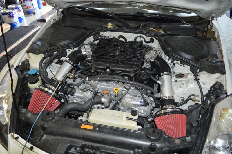

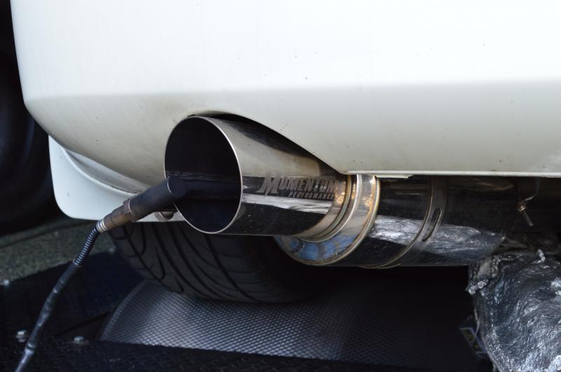

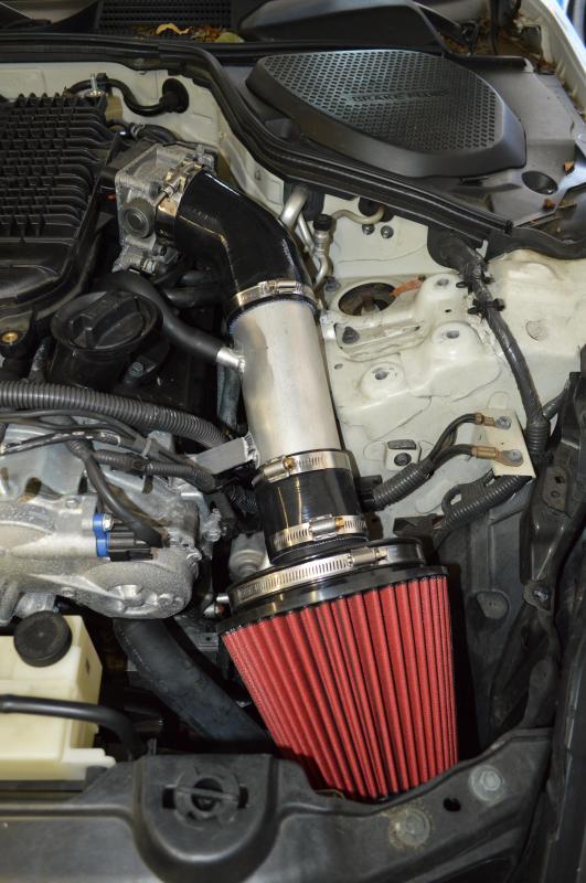

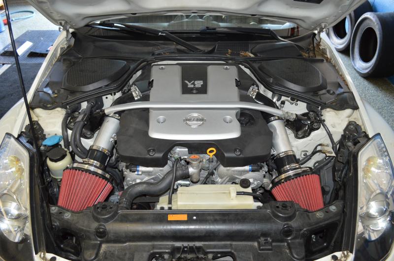

So I had my car tuned today with the 3" housings. Below is a picture of the dyno sheet, the run was done on a Dynojet, 91 degrees and 30% humidity.
Also there are some shots of the intakes and the dyno setup. I don't have my original baseline dyno run so the comparison is:
Before - Borla cat back, Berk HFCs, K&N drop in filters
After - Momentum Performance single exhaust, Megan/Top Speed Y Pipe, Berk HFCs and the CIN 3" housings
Passenger side:
Driver's side:
Engine bay just after I got the intakes put in:
Strapped to dyno:

Random shot of my exhaust:
Engine bay after everything was put back together:
The dyno sheet:

So your gains were similar even going from stock airboxes to the 3" setup...
Old Jul 12, 2014 | 06:05 PM
  #240
dilat3d's Avatar
dilat3d
Joined: Apr 2013
Posts: 116
From: LI, NY
Yup, the shop was Vinny Ten Racing by the way .. they were impressed as well .. interestingly the tuner told me that dyno they use is very conservative, not even a bolt on HR w/ cams has broken 300. Only 370s have broken 300 on it so I'm not disappointed with the numbers. Considering the results and the cost, I really can't justify any other intake setup on an NA motor (think Injens etc.). The only issue you could run into is heat soak which is the next thing I believe CIN is going to tackle.
As you can see on the dyno by the way, the torque curve is excellent and you can definitely feel it driving about town. I was told by someone who works in a reacing series that a lot of their intakes they run are normally larger than the actual throttle body which allows charged air to be at the ready within the intake which explains the throttle response being very good as well. Overall I'm happy
