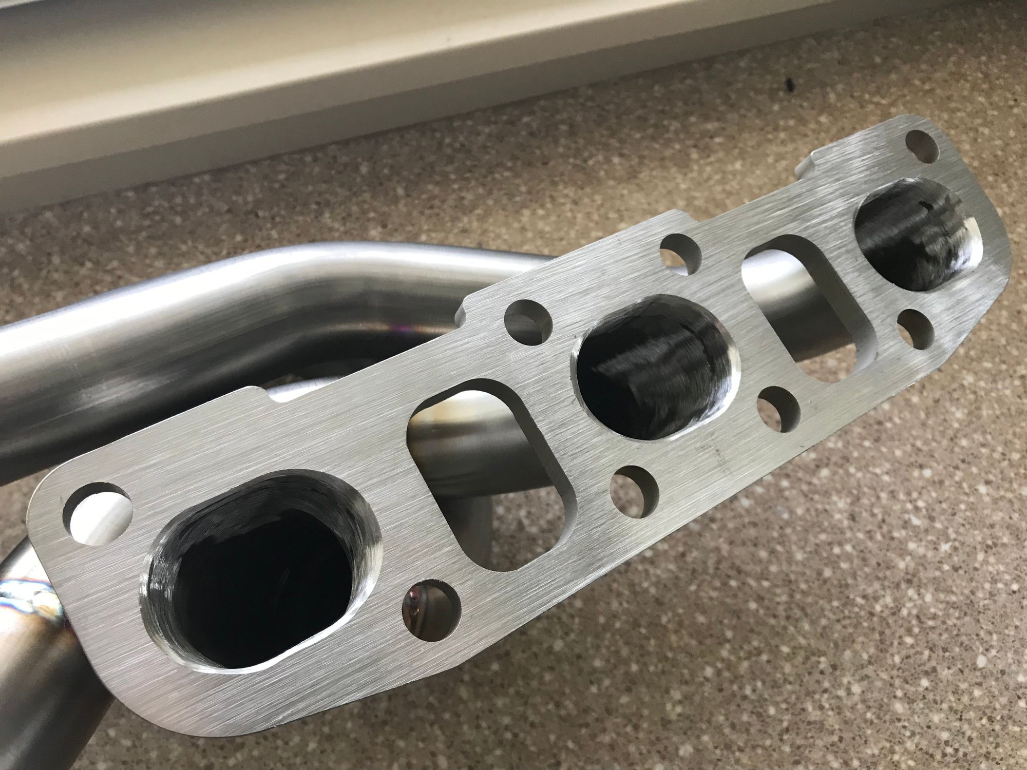

So I got my PPE long tube headers in. Great woohoo! Only issue (if it really is one) is the flange side of the header doesn’t match to the block bolt location when I need to put the gasket. Wondering what gaskets ppl put on these bad boys cause I can’t find **** to match the headers.

No metal gaskets are going to have that shape, HR gaskets are close but they are a ***** to use on DE engines

I have the 07 HR engine, can I jus buy a new stock gasket/aftermarket for the HR and I’ll be fine? My concern is at the corners where there’s no bolt will I loose power because of those weak points?
If I can use a new stock/ aftermarket gasket for the HR motor then I’ll do it, just wanna make sure I know what’ll come from it.

Oh, now I understand your concern. Should not be a problem, some companies don't make a left and right flange for headers (honestly don't respect such companies) but you don't need more than 2 studs per runner, that being said, you can always add 2 extra studs on each side if you desire.
