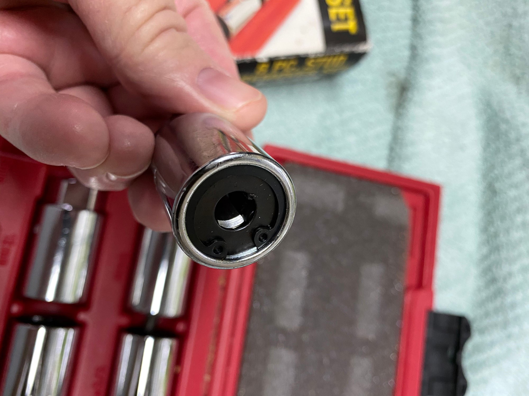

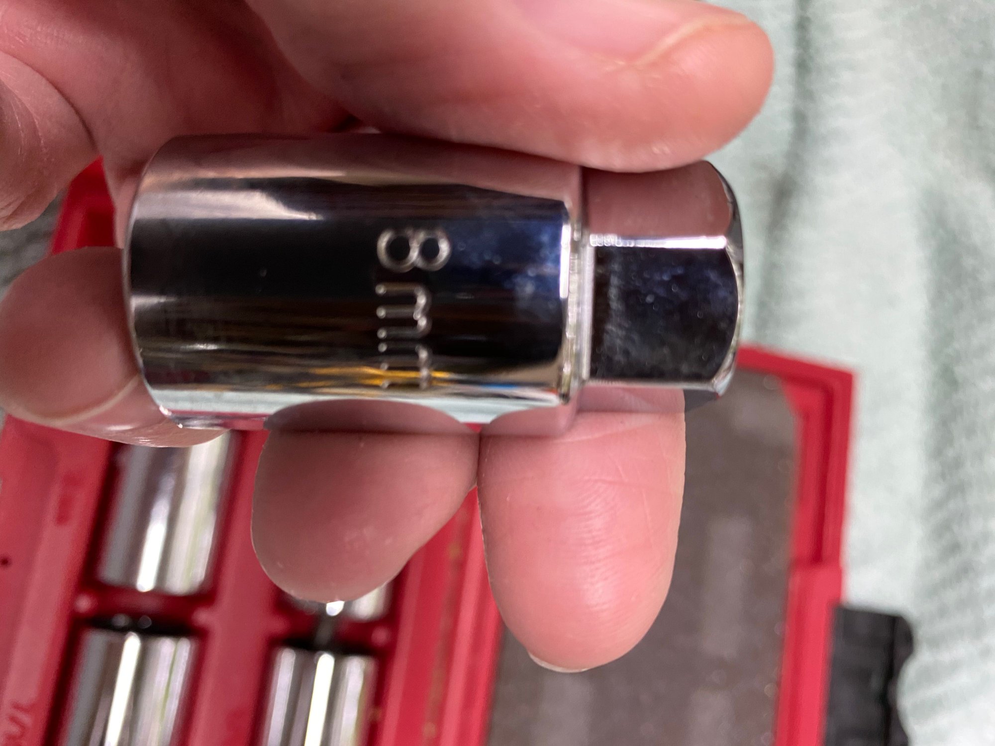

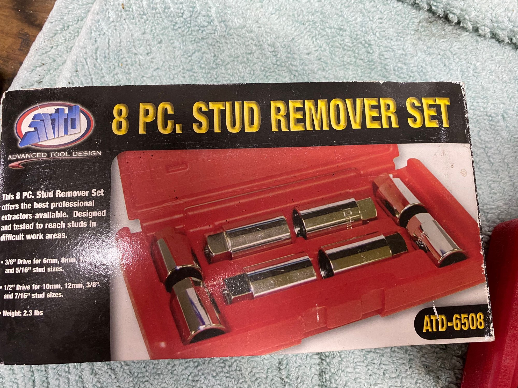

As mentioned above, soak the hell out of it, heat the flange & try double nuts or vice grips first.
If that's not possible, here's a stud extractor set that I had some success using on a badly rusted cat.
i didn't remember them being this much when I bought them.
ATD Tools 6508 8-Piece Stud Remover Set
Amazon Amazon
HTH
