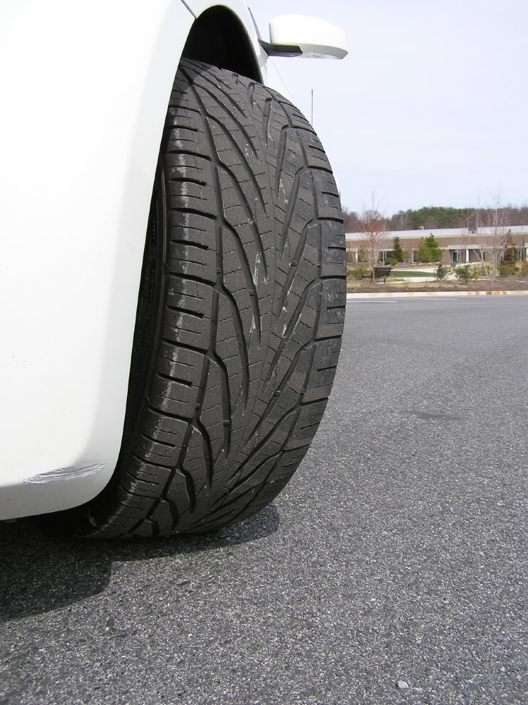

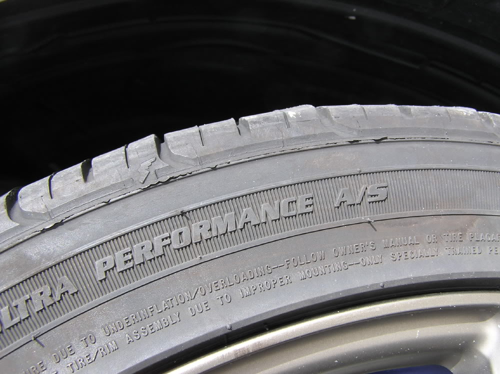

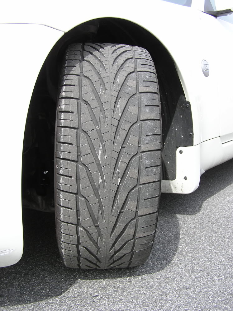

Old Mar 21, 2009 | 12:24 PM
  #3948
davidv's Avatar
davidv
Posts: 42,753
From: Tucson, AZ
Above: Tires after swap. You can clearly see the high low pattern now on the outside of tire. In fact the pattern continues to the center of tire. Horrendous noise is the same as before the swap. Tires have 21,340 miles.
Above: Saw tooth wear is now on the outside of tire.
Old Mar 21, 2009 | 04:04 PM
  #3949
ladyzed's Avatar
ladyzed
Posts: 573
From: Kamloops BC
Holy mother David. That is bad dude!
Old Mar 21, 2009 | 05:50 PM
  #3950
davidv's Avatar
davidv
Posts: 42,753
From: Tucson, AZ
I think I can get a safe 30,000 miles out of these tires. Next new front tires I will go 15,000 miles before the swap.

cheshirecat79
Posts: 15,936
From: Port St. Lucie, FL
Great pictures of the feathering, thanks for adding them for everyone to see. Would be nice if they could get pinned on the first page somehow for reference.
