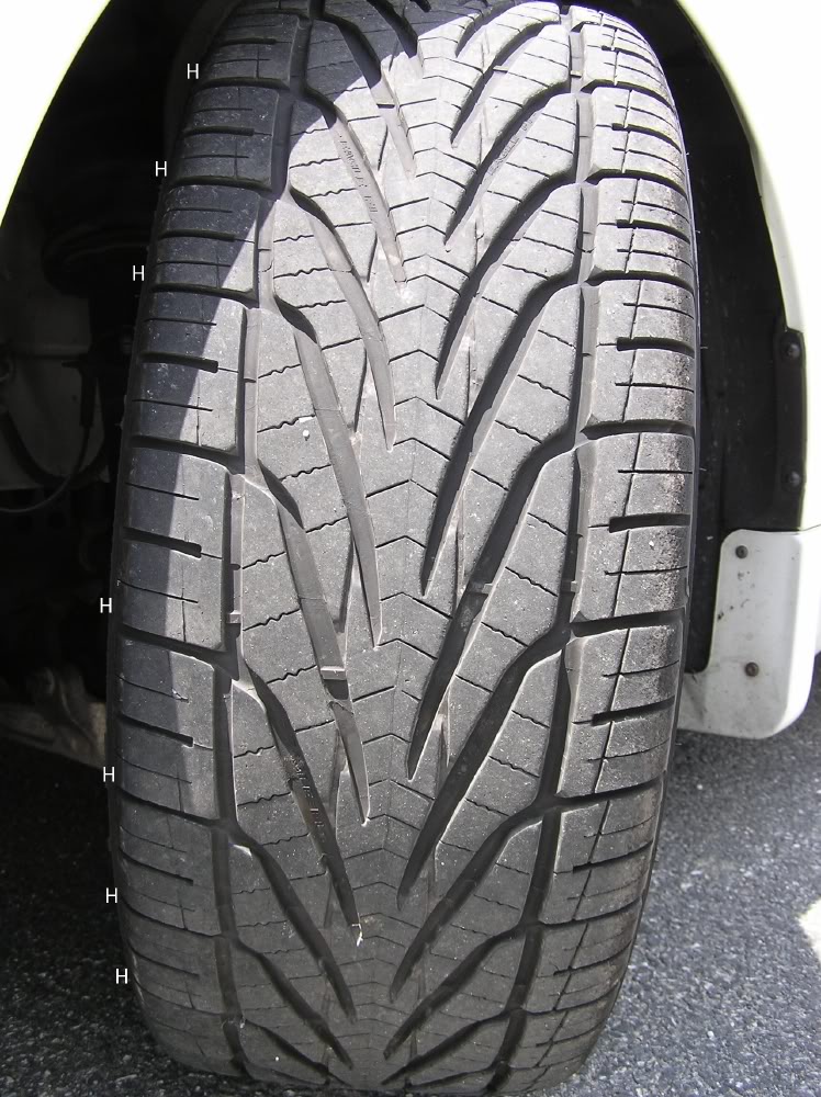

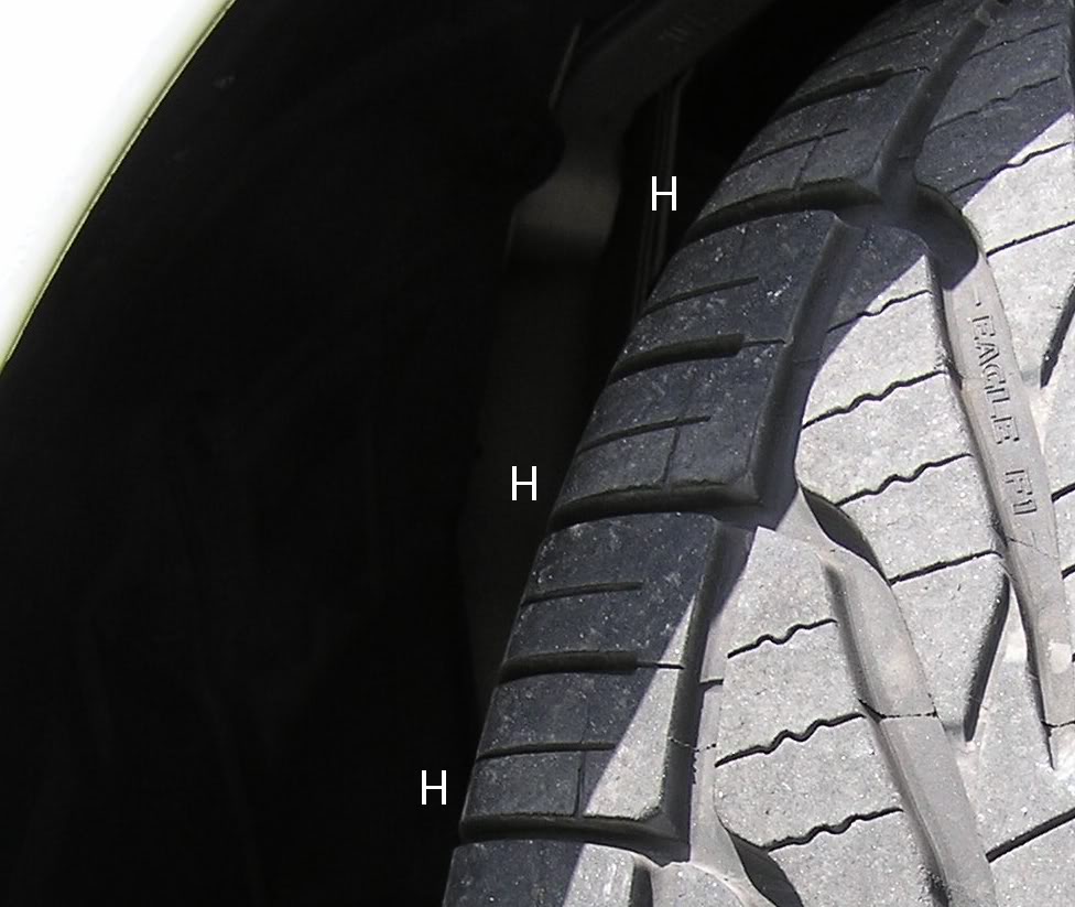

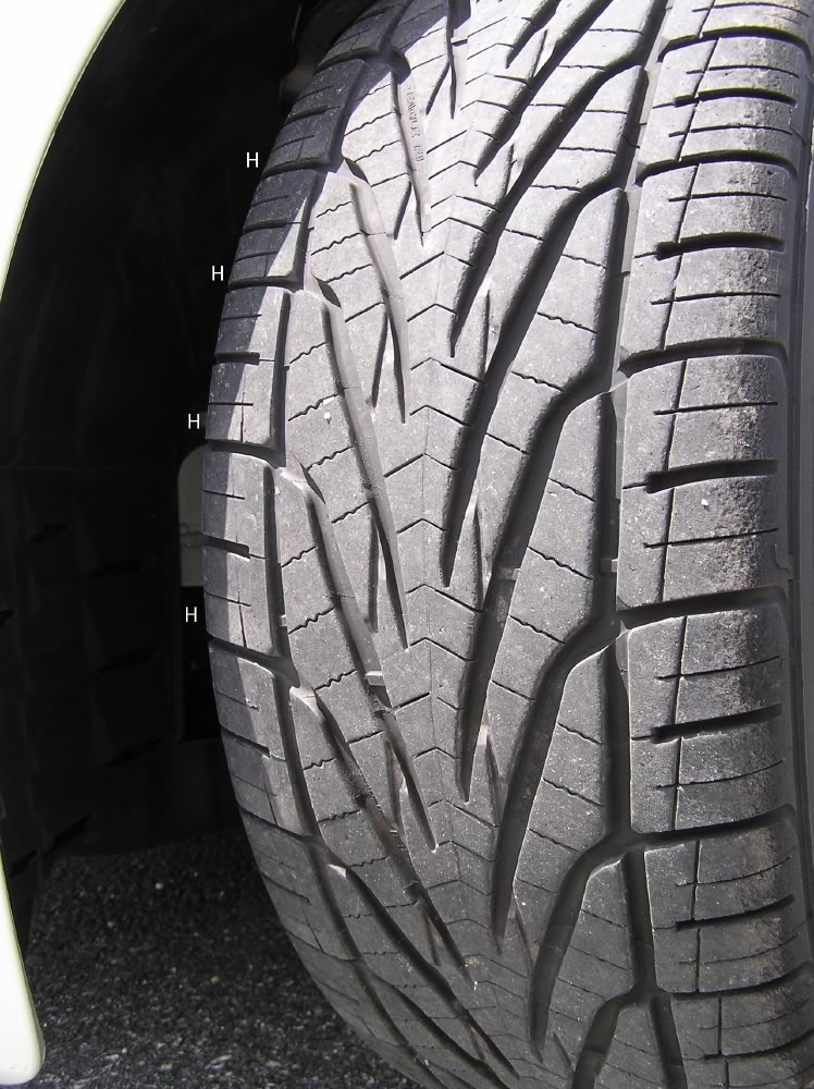

Old May 24, 2008 | 12:35 PM
  #3870
davidv's Avatar
davidv
Posts: 42,753
From: Tucson, AZ
After an alignment, several sets of tires and 45,200 miles, feathering is back. I have marked the high points on the photos. Those are the white portions of the tread blocks. The blocks are bevelled going from low to high, and begin again with a low point on the next block.
