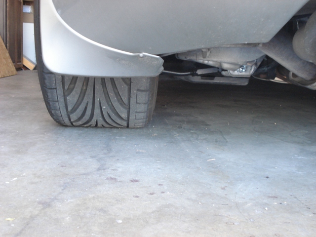

Been reading this thread for awhile now. Here is my life story on Feathering.
I bought new tires 3 years ago and never really noticed the Tire Feathering until I came on this site, then I started noticing the tire roar when I break. From what I have read there really is not a permanent fix for this issue. The last images are the picture of the feathering, you can see the signature zigzag pattern. I also attached the alignment specs when the tire was feathering, you can see the toe is way out.
Fast forwarded to today. I have 19 inch tires now and I hate for this issue to happen again. I bought the rear SPC toe and camber kit to try and fix this issue. The middle image is my current set up and alignment specs.
I am dropped on GF210 and D-specs.
My question is would the tire feathering happen again with the kit in place?
Do I have to do an by yearly rotate and alignment?
Attached Thumbnails Tire FEATHERING: FYI-alignment2.jpg   Tire FEATHERING: FYI-non-feathering.jpg   Tire FEATHERING: FYI-feathering-web.jpg

WOW! The photo speaks for itself. What I intend to do with new front tires is estimate the tread life (say 30,000 miles). Then swap tires at half that (or 15,000 miles). I know that is not a fix.

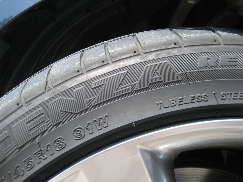

Finally got a few pics to upload. Not sure if the wear comes through very well in the pics. Still have not decided what course of action to take. Did get L-R rotate and alignment from Nissan (FWIW). Tires have almost 12k miles on them.
Talked to Forged in Atlanta. Said I need front and rear camber kits (rear too?) at a minimum, new springs too. Have read that others recommend control arms.
Thanks.
Attached Thumbnails Tire FEATHERING: FYI-img_1611.jpg   Tire FEATHERING: FYI-img_1612.jpg

I do not see the typical feathering pattern. If you drive though some white dust or sand, then take some photos, the feathering will stand out.
