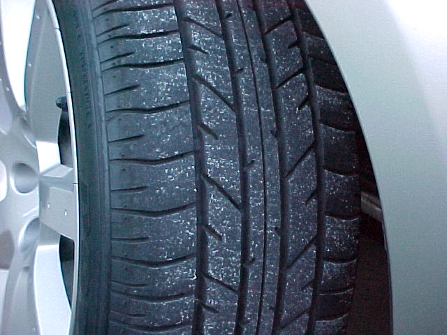

Default My feathering
Edit: I will get an alignment done an post before/after specs. Also will be opening a case with NNA. Any other course of action I should take?
Attached Thumbnails Tire FEATHERING: FYI-z_feather1.jpg
