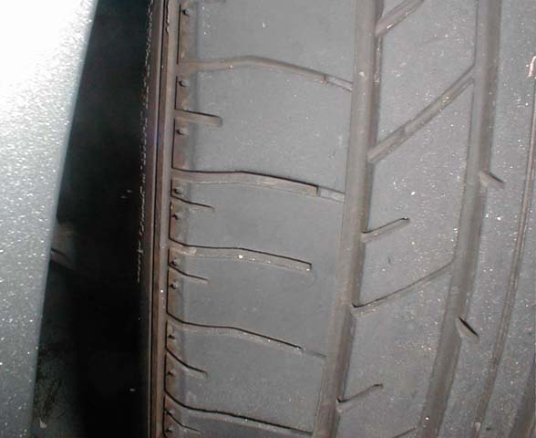

First drive- November 12th and I've got 15k miles on my SS Track. Had the alignment/ no tire swap (dealer suggestion) at 11,000. The noise is getting unbearable. I got the Track because I didn't expect to race, but I wanted the best the manufacturer had. I don't want to dump a bunch more $ into "fixing" my car.
Anyway, I noticed during a close inspection that the inside (problem child) tread blocks are baby butt smooth, while the rest of the tire seems scratched up. I don't know why. I'm not going to try to guess, but someone might have a clue.
It seems to me that I can cause my Z to bounce. It's easier at higher speeds. It won't happen while accelerating or slowing down. It's almost as if you get it to balance the weight front/back. Then, catch the smallest bump, and you're off! Bobble Heads for everyone.
Help- anyone.
Attached Thumbnails Tire FEATHERING: FYI-p1010023.jpg

Just a WAG, insufficient rebound on your rear shocks. I'm buying Konis when they come out.

I am not experiencing any feathering or cupping as shown and described in this thread. I have over 6,200 miles without any allignment changing on the stock tires. I drive very aggressively, and I really have no Idea why my Z isnt showing any feathering,
An observation......
Aggessive driving "may" balance the wear on the tires so that the feathering does not show up. More of the "outside" of the tire is being used and not just the inner edge.
Toe out and excess negative camber will definitely cause feathering of the inside edges of the front tires. Driving on the hwy only with a suspension tuned for "race track" use could cause this excessive wear.
About ten years ago in Germany, there was a problem with lowered BMWs (which increases the negitive camber) that would wear out the inside edge (or, overheat the tire and have a failure) of the rear tires when driving at speed on the autobahn. Great set-up for AGGRESSIVE DRIVING on winding roads, but bad for straight "highway" driving.
IMO, highway driving, excess toe-out, and aggressive braking add to the feathering of the front tires. And track use, (aggressive cornering) correct toe-in, and "lighter" hwy braking causes less of it.
Maybe the fix is to have a "TOURING" setting for cruisers, and a "SPORT" setting for track use.

I thought that was the idea of this car, daily driver for 5 days a week, change the alignment settings, and go racing on the weekend. Using your context, it seems to me that Nissan set up the car to go racing on the street as well as the track. If you cruise, you don't get even tire wear? If you drive the highway a lot, you get uneven tire wear?
So, still using your analogy, the owners who tiptoed around in Nissan's breakin period, got uneven tire wear and those who whaled the **** out of it had no problems? In a couple of cases, yes, they've posted and told us. For all the rest of us, seems a bit farfetched, but I just think most of the cars were out of alignment from the start. Those who drove the most miles got the feathering because they were out of alignment, IMO.
Oh, check out a website called, www.familycar.com, they have a very readable section on alignment that even I can fathom.

I can't wait for Nissan's fix anymore, so I decided to buy the Eibach Pro-Kit even though I DO NOT like to lower the car.. It's the cheapest route for now. I will update after a few thousand miles..
I currently have 14,000miles total, and 1000miles on the new S03, warranty by the dealer. No sign of feathering on the new tires so far...

Did you have it re-aligned after you added the Eibachs?

No, IT doesn't look like it needs the alignment, the front is less than 1" drop, from eye level, the tires doesn't look it has too much change (camber wise).
Lets see what happen in a few thousand miles.

Its your choice, but I don't thnk you can eyeball the difference. If you begin to see wear, it mat be too late. Just trying to help.
