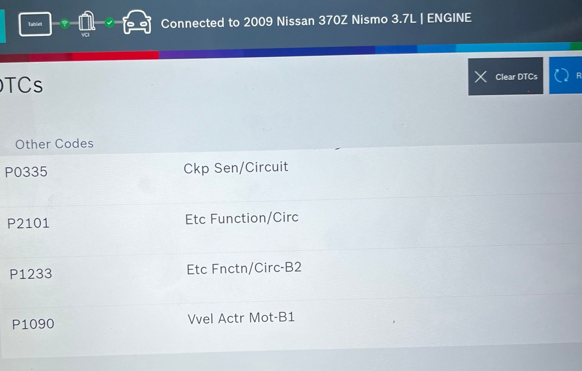

*370* I know this is a long shot but I am having the same problem but I was told it was the flywheel being misaligned if anyone could help it would be greatly appreciated
I have videos but they’re too big to upload
