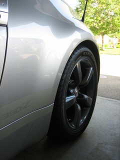

yeah put those back in the front and 275/40/18 for the rear.
