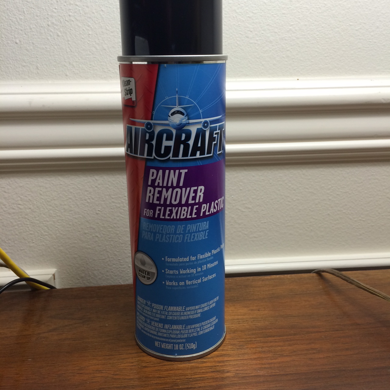

Default interior paint stripper
There are a lot great threads on how to re-paint interior trim pieces, particularly the driver's door interior handle (officially it the "power window main switch finisher". There are just about as many recommendations for paint strippers to strip off the old rubber-like paint as there are threads. I think I tried most of them (rubbing alcohol, spray oven cleaner, brake fluid, pine cleaners, citrus cleaners, scratching it off with a knife, etc., etc., etc.) and found most of them to be a lot of work that rendered a very uneven inferior result that required lots of sanding and primer buildup and more sanding to make it paint-ready.
But then I stumbled on the ultimate solution: Aircraft Paint Remover for Flexible Plastic. Spray it on, wait 10 minutes, and all paint and primer literally sluffs of the plastic without doing any damage to the plastic trim piece. Rinse it with water and you are done. It leaves nothing but the plastic trim behind.
I picked mine up at the local auto parts store but it can also be ordered online from several places.
Have you used this on the textured plastics like the glove box lid? I couldn't find any decent way to strip that without damaging the texture.
I have only used it on smooth surfaces and have not used it on textured surfaces. It dissolved the paint and did absolutely nothing to the underlying plastic rigid window switch panel on my door.
Just wanted to update this thread regarding the Aircraft paint stripper for "Flexible Plastics." I purchased a center waterfall/cubby set from a wrecker. The cubby door was already damaged from the previous owner of the wrecked vehicle (drilled a hole through it to mount a mechanical clock!). Anyway, I didn't care if this lid was damaged so I used the Aircraft paint stripper on it for testing purposes.
At first it looked like it was working great without damaging the underlying plastic/texture. Note that I did NOT leave this stuff working on the paint longer than 10 minutes. I also tried this stuff on the cubby door's spring loaded button.
The end result, is that the Ping-Pong Texture was deformed. The underlying plastic was softened up quit a bit, thus increasing the deformation of the plastic surface while scrapping/scrubbing off the old paint/primer. This was true for both the cubby lid and the button/latch. Once this stuff eats through the paint/primer it starts melting the underlying plastic. Really reminds me of how Acetone works on plastics.
If you plan to use this stuff, there is enormous risk involved. The manufacturer's instructions state not to use this product on "hard plastics."
I'm confident the product can be used successfully, but extra special care needs to be taken about how long you leave it on the painted plastic and how you remove the paint. In my case, 10 minutes seemed to be too long, but 5 minutes seemed to be too short. Using a scraper on the textured interior bits will result in deformation. Use a scotch brite pad or something similar.
The cubby lid and button are still re-usable, but I need to sand out the deformed button/latch and cubby door followed by multiple applications of primer and sanding to get an acceptable finish.
When I get to repainting my interior bits, I think I will go the alcohol/sanding route, at least for the textured areas. Good luck!
