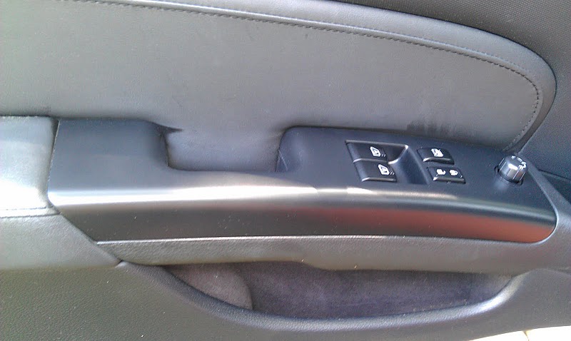

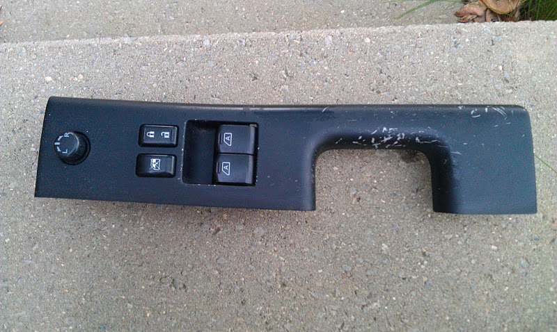

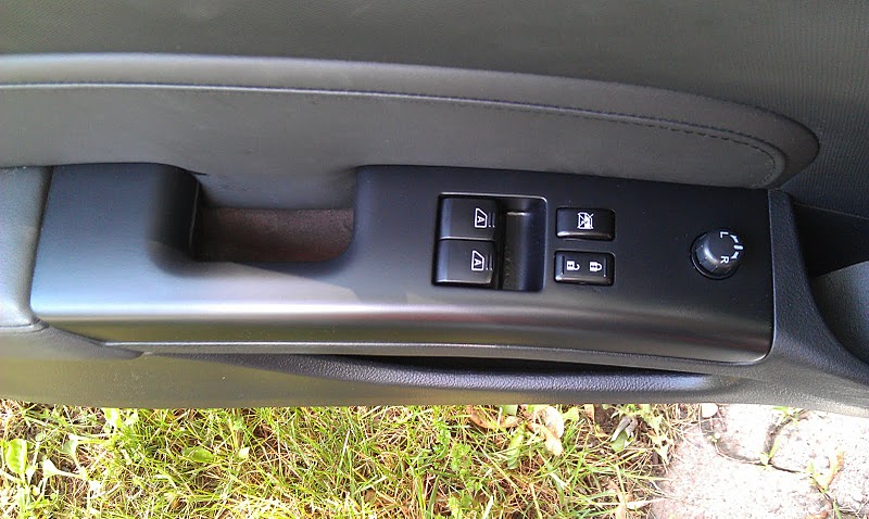

If you'd like to return it to the stock look but have it be more durable then i'd go with painting. I just did mine and it was pretty easy. Only takes a few hours.
Sanding the original rubbery paint was pretty much impossible, so i scraped it all off with a knife instead. Just keep the knife perpendicular to the part so that you don't accidentally cut into it. It should only scrape off the black paint and get you down to the brown primer underneath.
After it's scraped down to primer you can sand the part. I used 800 grit. Make sure sand off any remaining bits of the black paint as well as smooth out any scratches you made with the knife. If you missed a spot with sanding you'll be able to tell once you start painting.
Now wash the part. I just ran it under water in the tub and rubbed hand soap all over it. I then tried it with a towel. Oh.. and be sure to wash your own hands each time before you start painting.. if you leave an oily finger print then the paint wont adhere very well.
I hit it with 2 coats of primer then sanded it down a bit to make sure it was nice and smooth. I waited 10 minutes between the 1st and 2nd coat. Then waited 30 minutes before i sanded it.
Wash the part with soapy water again. Make sure it's dry. Now paint on the black paint. I had a lot of problems with this paint at first. It would look nice when wet but it kept drying splotchy. I eventually learned that if it dries splotchy then just hit that spot with a very light coating.. basically a dusting, and it seems to smooth it out. If you get one spot with too much paint then it is sure to dry with a visible splotch.You only have to wait about 5 minutes to see the splotches.. at which point you can hit it with the light dusting to smooth it out.
I let it dry for about 20 minutes (i had about 5-7 coats of black paint on it due to learning/failing at fixing the splotching). I then did a light sprinkle of clearcoat on it and it gave it a nice little sheen. It was a very thin coat of clear though.
Since i had so much paint on the part i let it dry/cure for a few hours before installing it. That wasn't quite enough time though. When i was pressing in the mirror control i left a slight fingerprint indentation in the part. If i were doing it again i would wait a day or two before installing it.
I attached before/during/after pics plus a pic of the 3 cans of paint i used.
here are the UPC codes:
primer = 026916946928
black = 026916399823
clear = 724504013013
Attached Thumbnails Interior Scratches - Repair Discussion-door1.jpg   Interior Scratches - Repair Discussion-door2.jpg   Interior Scratches - Repair Discussion-door3.jpg   Interior Scratches - Repair Discussion-door4.jpg   Interior Scratches - Repair Discussion-paint1.jpg

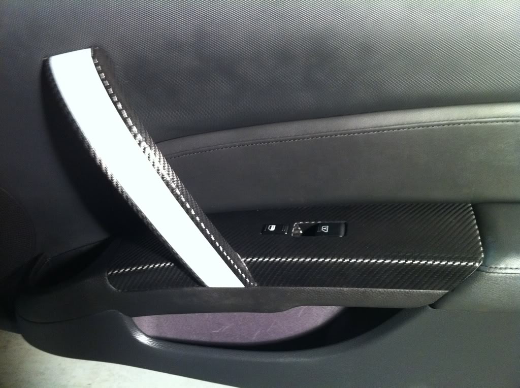

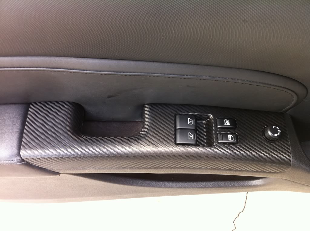

Originally Posted by maXmood
mine has one or two scratches at the most, but i'm gonna do that and wrap them in CF..
thanks for the removal pics!

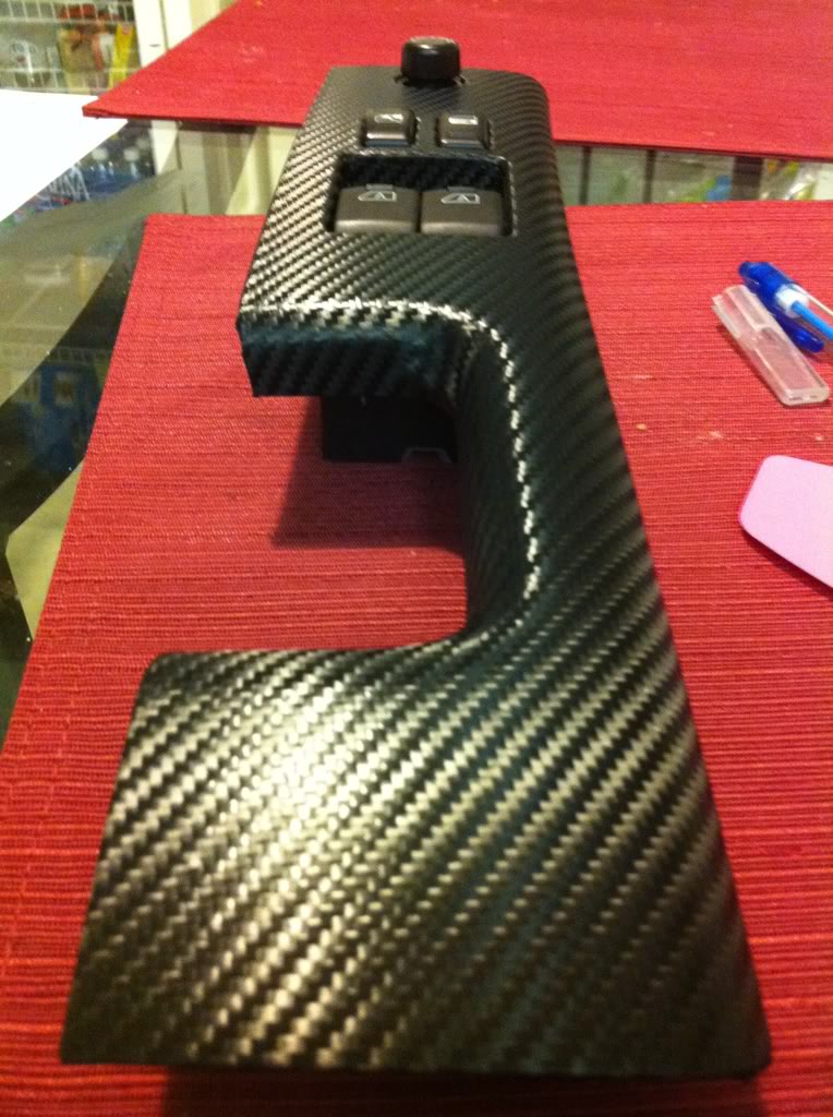

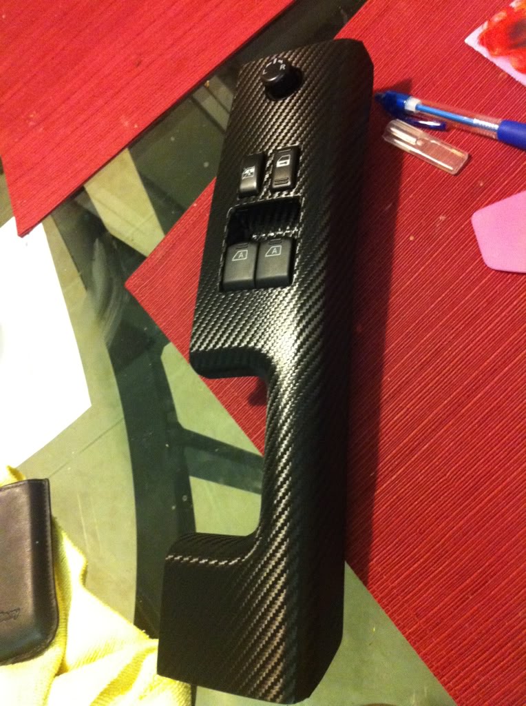

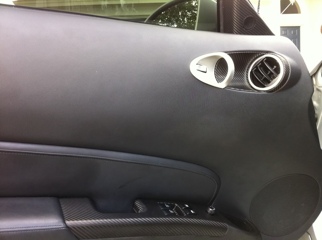

Yep that's what I just did and they came out great.
