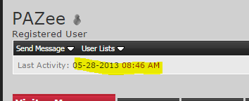

Have you manage to fix it. I think it must be something with the headers. I have been using motordyne tdx exhaust and motordyne art pipes (instead of cats) for quite some time now. This noise has been gradually increasing over time. So I think the problem is coming from the OEM factory headers which is the only thing that I still haven't replaced.
Some feedback would be greatly appreciated peace out

he hasnt logged in for 4 years, might be waiting a bit for an answer.... not to mention thread has been dead for almost 10 years
