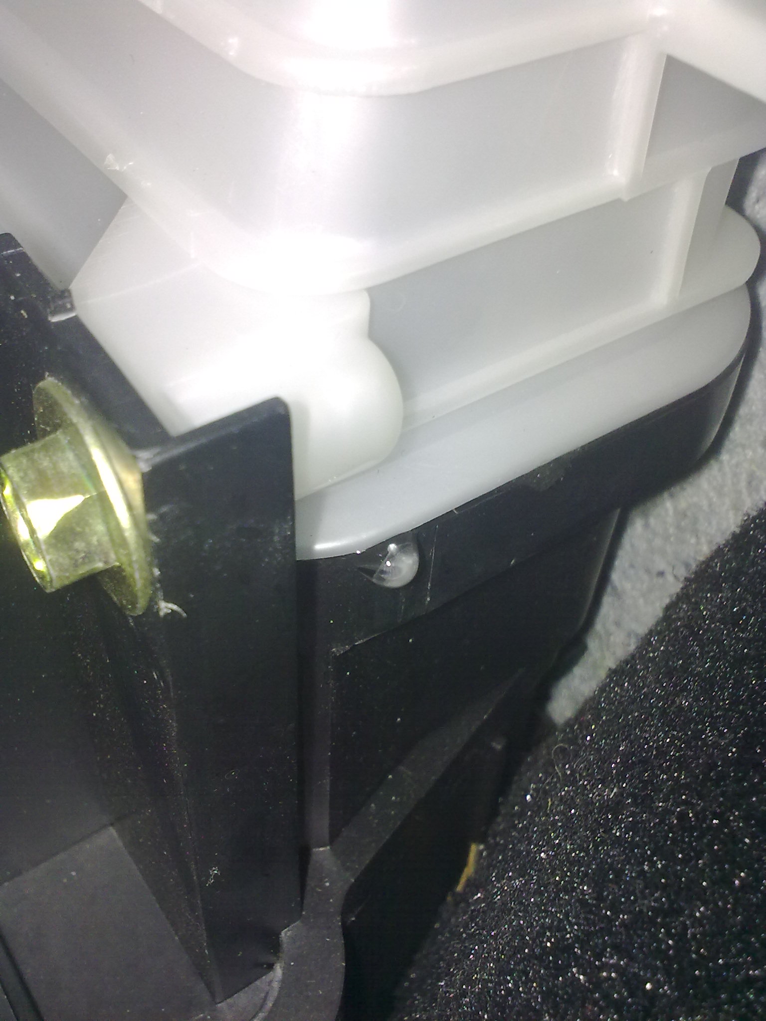

As i went into my Z today, i noticed that there is some water on the passenger side floor mat. I looked up and found out the place that the water came from. The thing is that when i turn on the A/C or heater, the water drops start and stop when i turn off the A/C ir heater, it is also worth mentioning that it is rainy outside..there r a couple of pics. any help would be really appreciated...sry for the bad quality...

it stopped raining now and its sunny so i will try turnin on the A/C-heater and checkin if there is still a leak or no. this should let us know if it has anthn to do with rain...

just checked...no rain and sunny and still leaking im trying to uploading a pic but its not working

these r the pics...sry for the bad quality

If it is only leaking with the AC on most likely your evaporator drain is clogged. Condensation in the evaporator case is normal, and there is a drain the is supposed to empty it under the car. If it is clogged you will get a problem exactly like you are describing.

do u know where the drain could be found?

I'm not that familiar with the Z. I'll see if I can find it in the FSM when I get home.

A leak from the engine cooling system would have the smell of antifreeze, so that's not the problem. I'd check for a clogged evaporator drain tube per post #3. It's #92950 here:
Note: The condenser is in front of the radiator, the evaporator is in the cabin.
