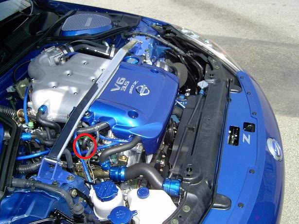

Its what circled in red to help you out. Since that last link has two many different jumps and a log in required to view it.
