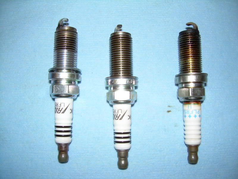

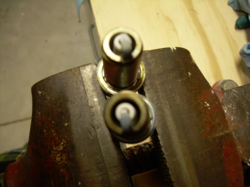

Pulled plugs: 1 & 5 have oil on the threads and burnt white residue on the ground. See pictures below.
Picture 1
Far left - new plug from cylinder #1
Middle - new plug from cylinder #5
Right - old plug from cylinder #5
Picture 2
Close-up on white residue
General consensus head gasket failure?

Old Dec 30, 2011 | 03:22 PM
stoffius's Avatar
stoffius
Joined: Dec 2008
Posts: 942
From: Atlanta
Just got car back from dealer. Car was suffering from vacuum leak, clogged injectors, and water in the fuel tank. Runs like a champ now....and a bad pcv valve.
