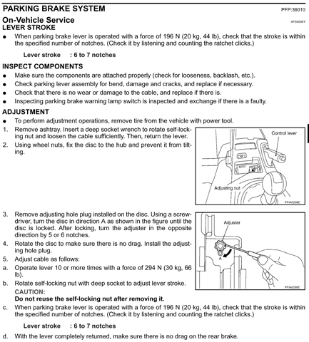

I would mention this at the 7.5k service, dealer should be able to adjust. Adjust requires removing tire!

Default Drum parking brake
This is the braking system adjustments

We had the same problem. The dealer's service department fixed it during the last service.

I have this same issue with this weak parking brake. I had it "adjusted" twice already and it fixed the problem for a short while... it is now back.

I had the same problem and was told that the settings were according to spec. On level ground, it's fine but in my driveway it is not; therefore, I leave it in gear as per the owner's manual.
