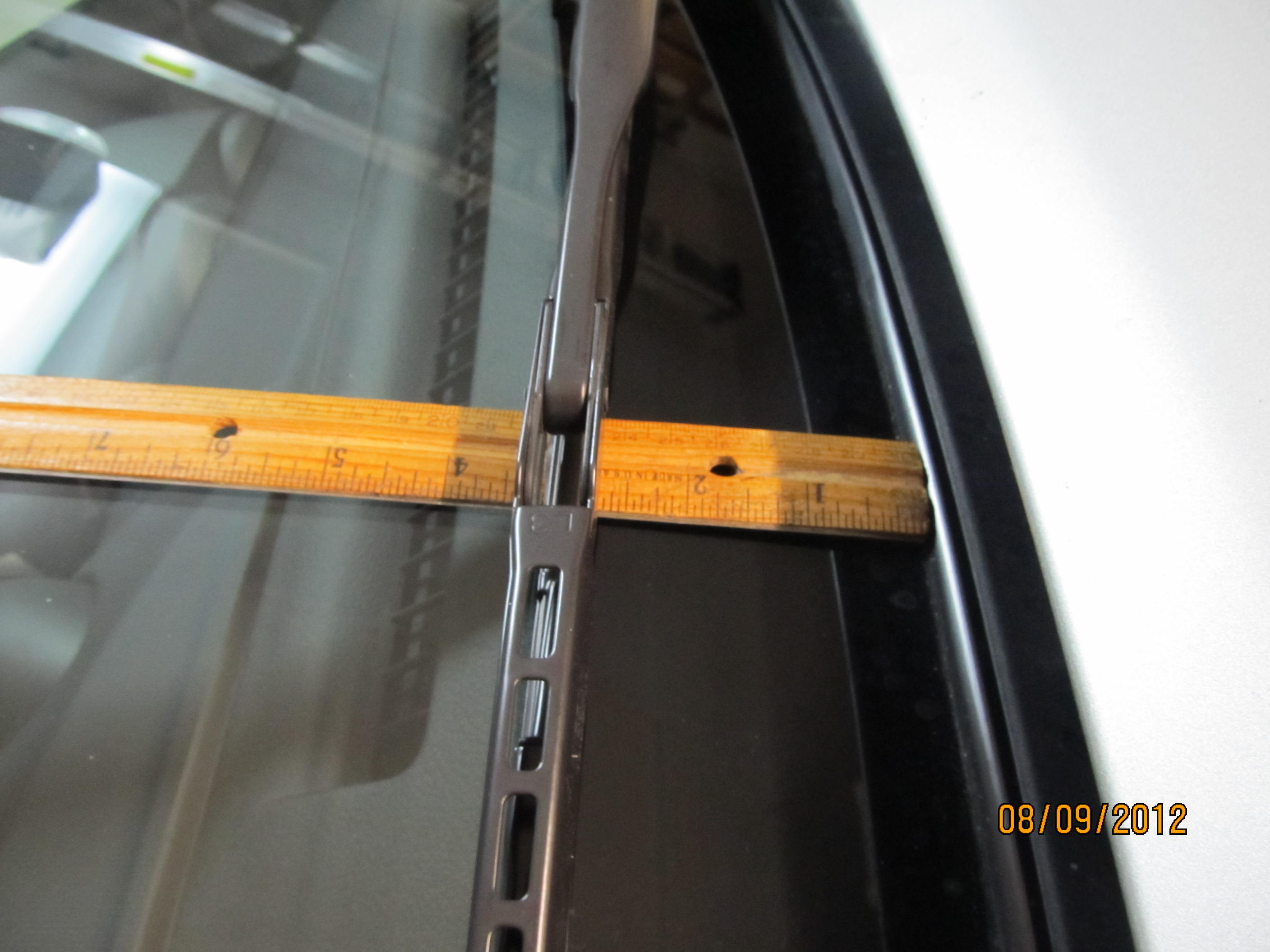

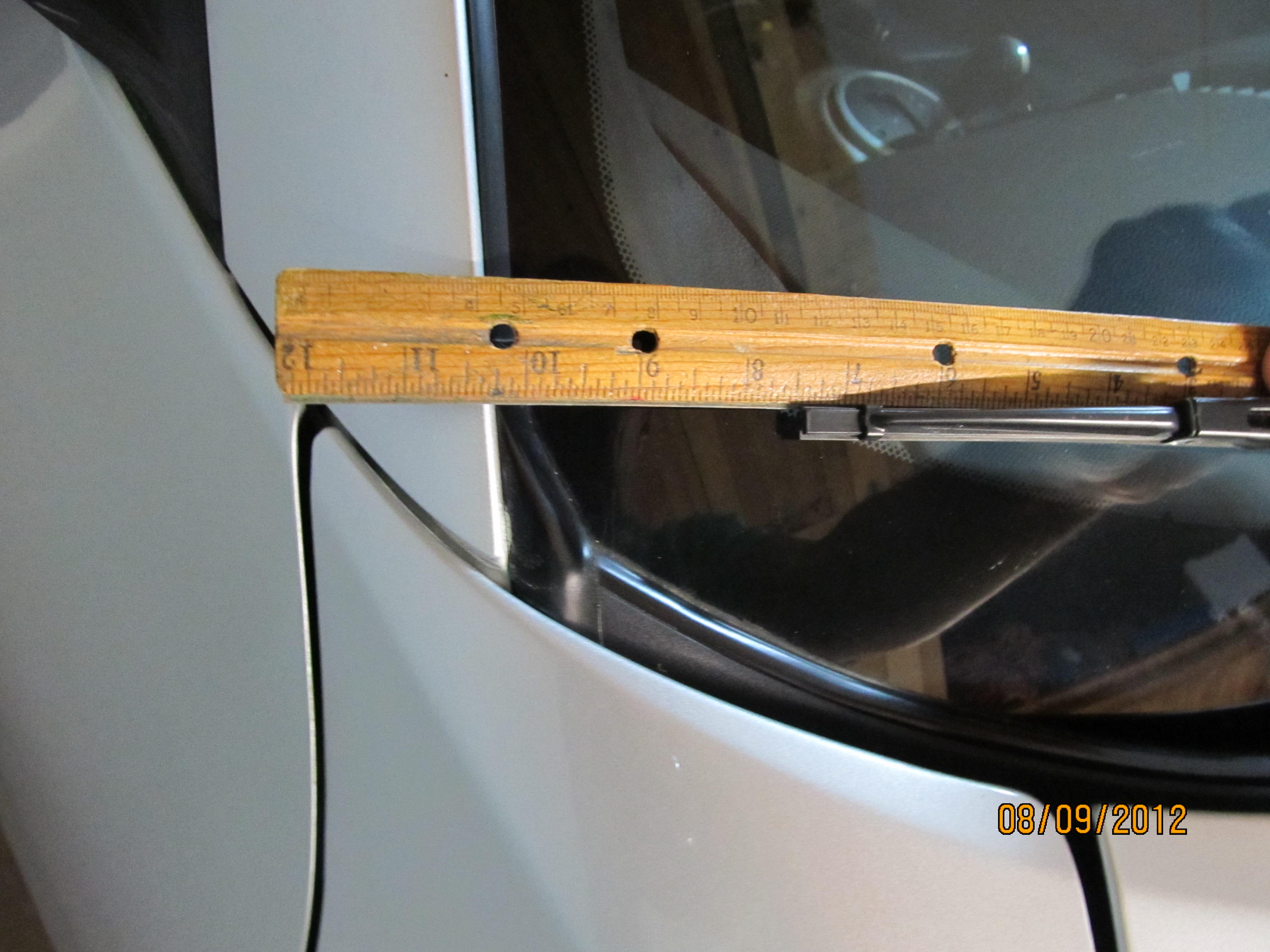

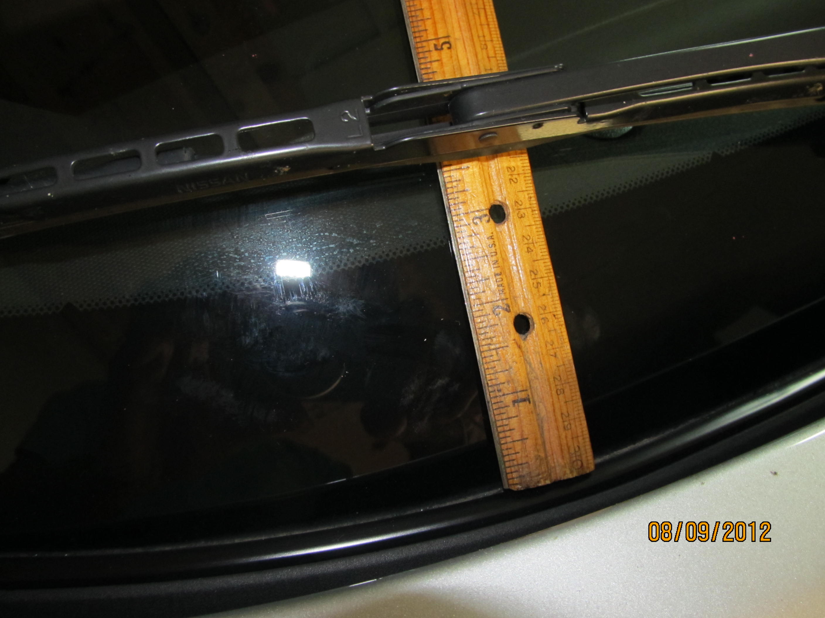

Measuring from the lower side of the end of the wiper arm where it connects to the wiper blade and perpendicular to the arm, it's 2.75 inches to the bottom of the glass on the driver's side and 3.5 inches to the bottom of the glass on the passenger side.
The driver's side wiper blade is angled up just a little bit (maybe 1 or 2 degrees).
The passenger side wiper blade points straight at the junction of the gaps between the A-pillar, the door, and the left front fender.

Can you post pics?

Here ya go.
Attached Thumbnails Windshield wipers issue-miscellaneous-july-2012-on-004.jpg   Windshield wipers issue-miscellaneous-july-2012-on-005.jpg   Windshield wipers issue-miscellaneous-july-2012-on-006.jpg
