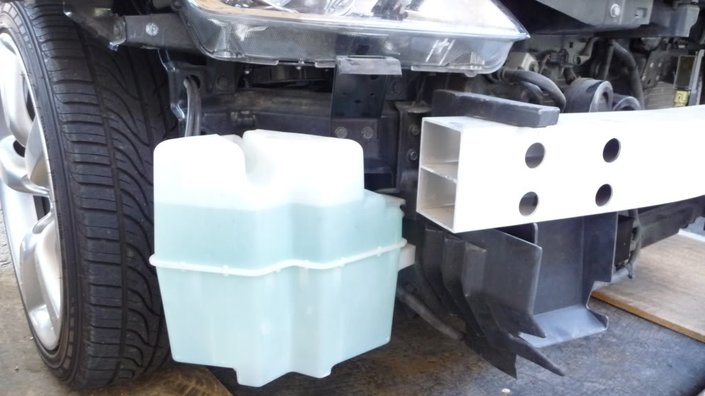

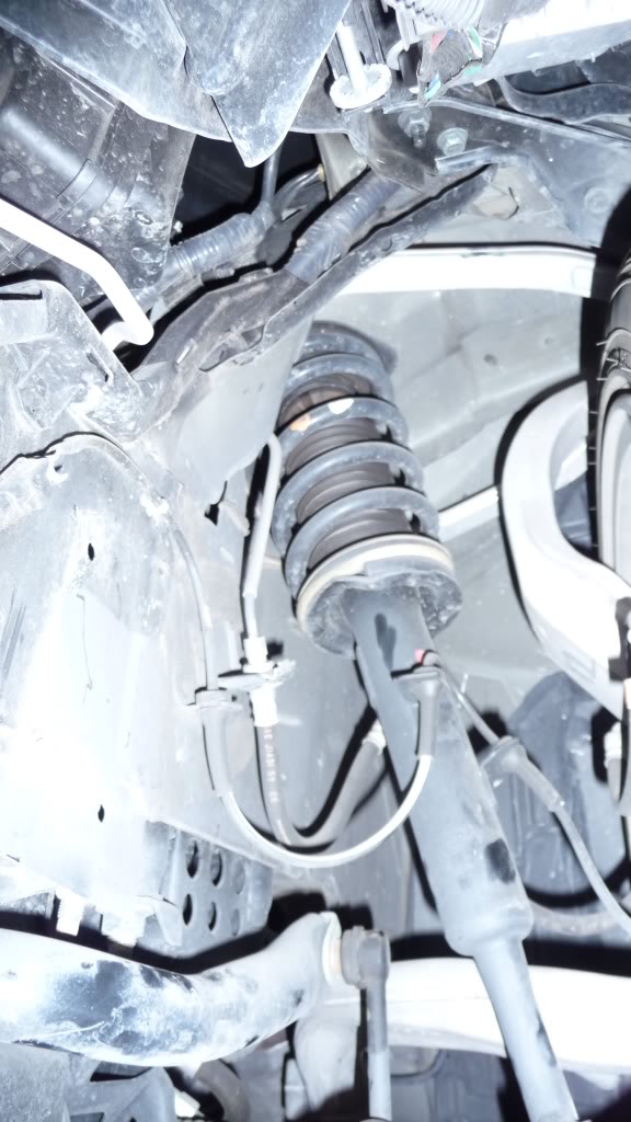

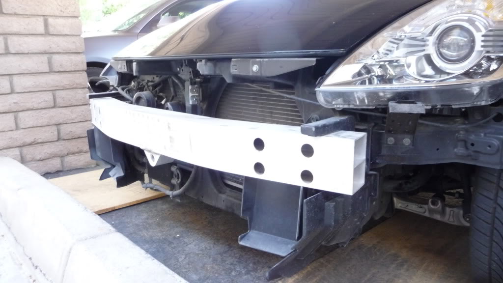

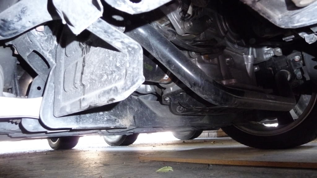

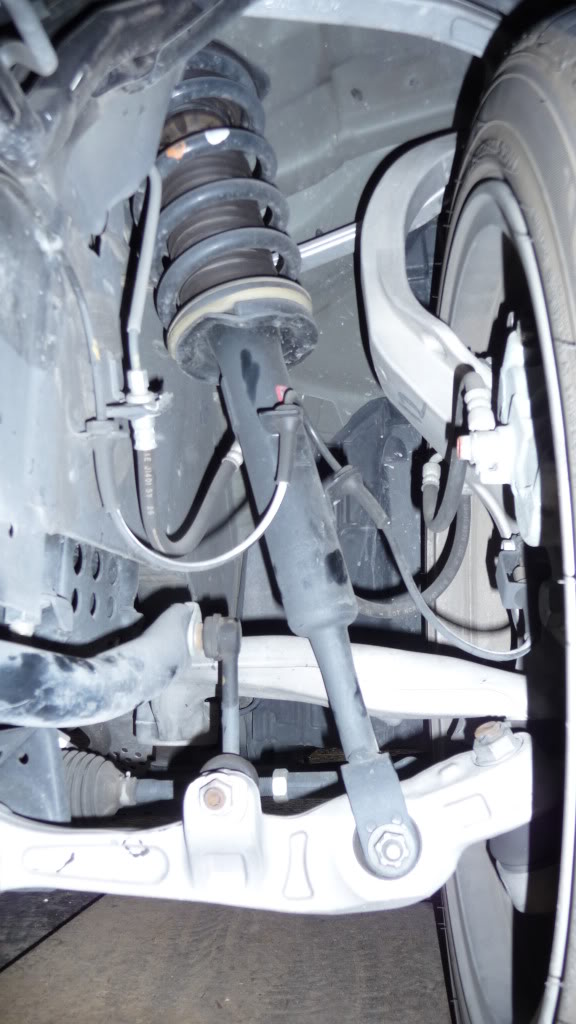

Today I took the bumper cover off. Could not see anything wrong myself so I took the Z to Pitstop Performance. They took it for a test drive. He said he heard the sound once coming from the divers side. They put the Z on the rack and could not see anything wrong. I drove it home and the noise is still there when I go over bumps kind of hard. Not sure what to do now but sucks that I can't find the source. I put the bumper cover back on so I can continue to drive it. Here are some pictures to entertain...
