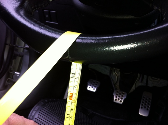

wup, I have an 05 touring and went out right quick to measure it
with the steering wheel all the down and the floor mat moved out
of the way.

I can't quite make out the measurement from the floor mat to the wheel in your picture. Would you mind measuring again and replying back in inches? Thanks!

Nevermind...
The pic loaded better, I can see the measurements now Thanks.
