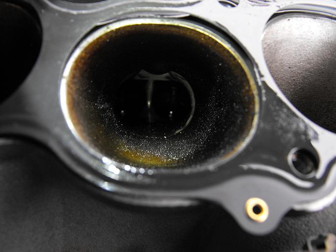

Here is the lower intake runner to the #4 cylinder. (not sure if I posted pics correctly)
I also had what I consider a significant amount of oil residue through the upper intake plenum that I assume was from the pcv valve being stuck and allowing oil to blow back into the intake.

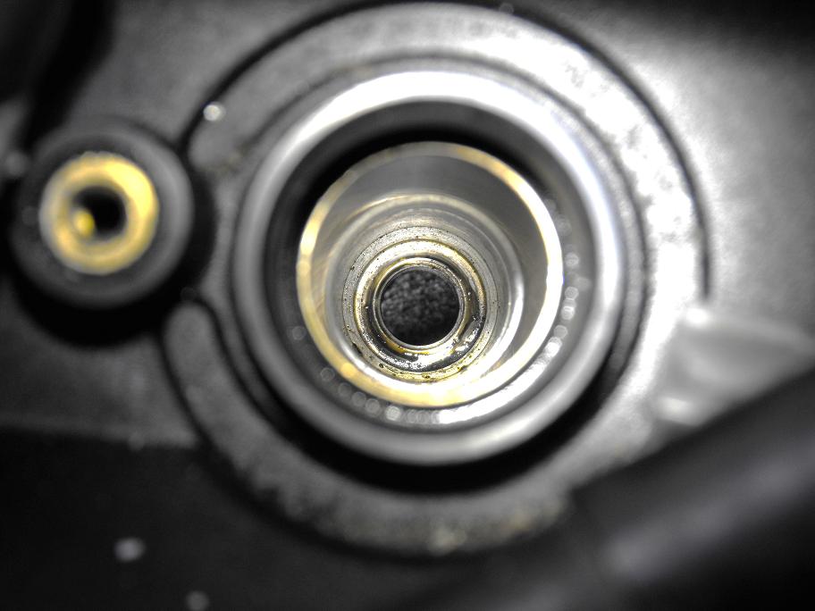

Here is a pic of the top of the #4 piston. All other pistons were relatively clean with only slight discoloration.
To recap what I've done so far: new valve seals, timing chains(pri and sec) since I already had the cover off, timing chain tensioners, valve cover gaskets, upper/lower intake gaskets, checked out all coils, replaced coil plug boots, plugs(constantly) and pcv valve. I'm about at my wits end trying to narrow down the source of the oil smoke. About the only thing left that I believe is left to do is rings. Could someone please please please tell me that I am leaving something out of the process of elimination before I get to having to completely tear the engine down?
