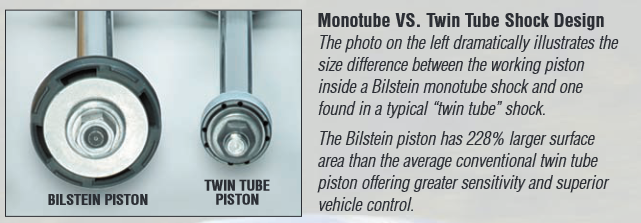

If you just want to fix your current problem as apposed to modifying/ "upgrading" your suspension.....
I recommend a set of Bilstein HD shocks for a good combo of ride and handling, or a set of Koni "yellow" sport shocks for improved handling at the expense of some ride quality.
I have used the Bilstein HD's on our Magnum RT and my Father-in-law's C6 Corvette. Both applications resulted in improved ride AND improved handling. (slightly)They were inexpensive for both cars (the C6 Corvette HD's were ~$90 each) I have no Idea why they are >$200 for the fronts on a Z. The Koni's are actually on special and cheaper than the HD's at the moment. (at tirerack)

The Bilstein HD's are monotube shocks. I've attached an image discussing the differences between monotbue and twin tube shock design which I got from Bilstein's website.
