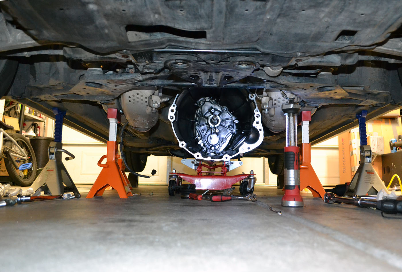

Will I need to realign the clutch/pressure plate/flywheel when putting the transmission back on? I plan on replacing the CSC without taking the trany from under the car. Just take it off and slide it back far enough to work.

If you don't loosen the bolts holding the pressure plate to the flywheel, the clutch disc cannot move, so you won't need to realign it.
I doubt there's enough room to do what you're planning, though. Please let us know how it goes.
Thanks, man. I saw a post on a forum, guy said he did just that. Took the transmission down and rolled it back far enough to get in there and swap the CSC.

Replacing clutch cylinders. CSC is leaking out of bell housing. New clutch?-jewsxut.jpg
It worked out pretty well New master (Wilwood) and slave (Zspeed), plus steel lines.

Originally Posted by stascom
Hey, what kind of transmission jack are you using and where did you get it from?

Harbor Freight. $80.
