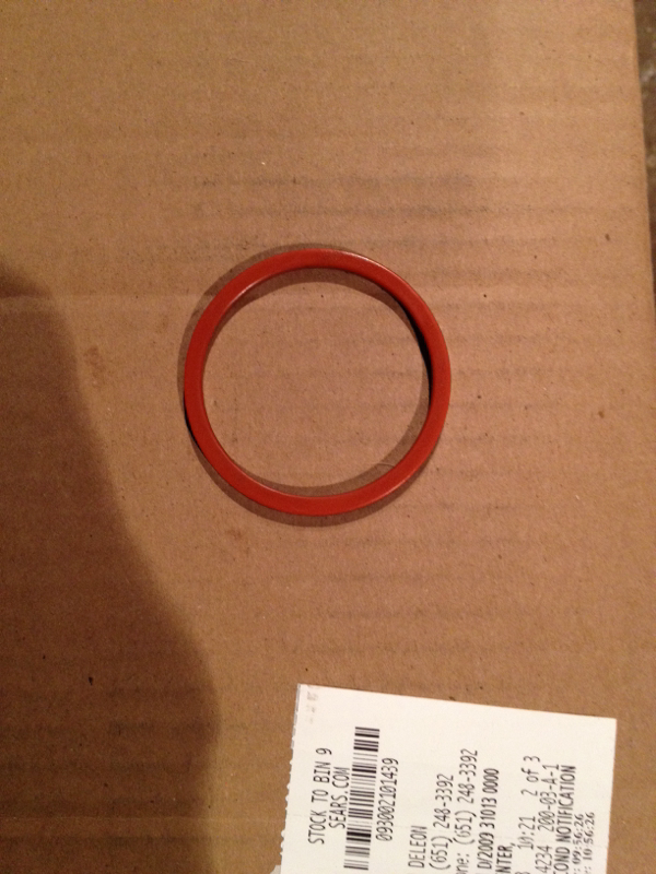

My g had this issue and it kept getting worse. Yes there is a ring behind the oil cooler. It's cheap. I looked for the part number but couldn't find it. It was easy to do to I had just changed my oil right before it went so I had to do another change less than 1k miles.
This is the old one, the new one is black

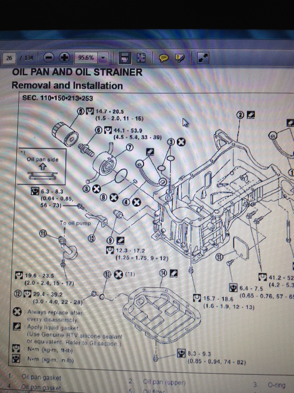

Sorry for the bad pic but this is from the fsm

Originally Posted by 350slug
Attachment 359154
That's perfect. Thanks a ton.
