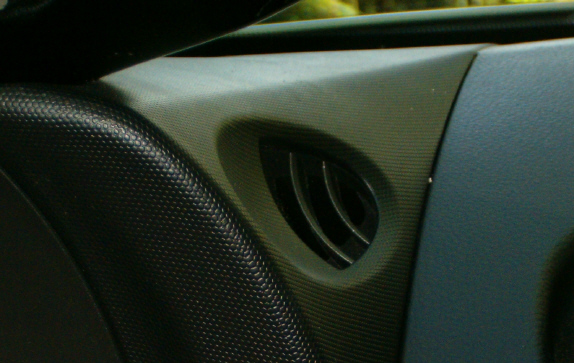

Thankfully my rearview mirror is silent at present, but the resonant vibration from both of these vents more than make up for it. If anyone has a fix for them, I'll give it a shot a post a DIY. Local dealership incompetent. (driver's side vent shown below)
