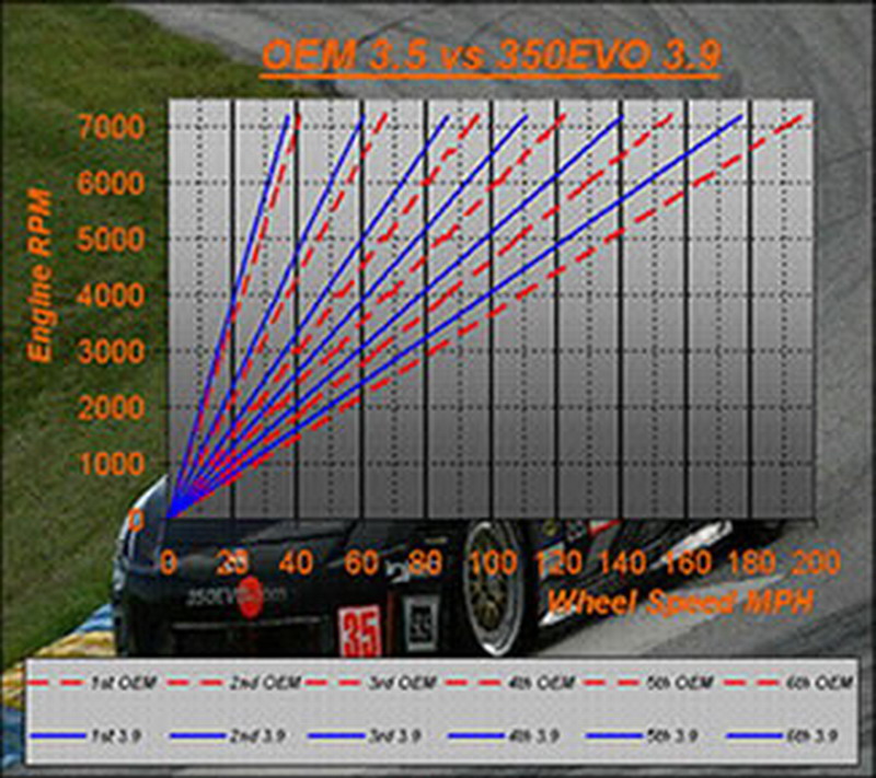

Here you go. This should help.

I don't get it. whats the benefit? Looks like you hit higher RPMs at lower speeds...so you are cloesr to your peak?
A short 350Z final drive ring and pinion drastically improves acceleration out of corners and down the strip. A short final drive ring and pinion thus is a great addition to any 350Z that needs an edge in acceleration. This 350Z short final drive ring and pinion is about a 10% reduction over the 350Z OEM final drive (the OEM 350Z ratio is 3.538). Without costly engine modifications, you can get the acceleration that equals much more powerfull cars. Best of all, you don't put any additional stress on your 350Z engine or drive train.
