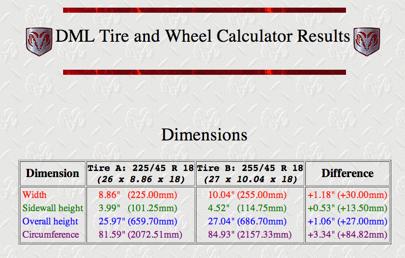

The difference in tire height is 27.0mm. I think you are OK.
